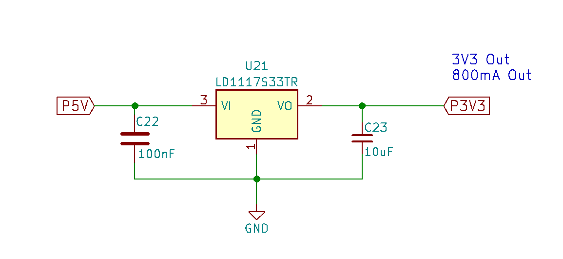

    I was using the TPS54531 but is step-down. I need it for low voltages. 30V max.
    Input Voltage -->  1~6S Lipo battery
    Out 1 --> 5V  2A
    Out 2 --> 12V  (is enough with 500mA).
    Out 3 --> 3V3  800mA (I was thinking of using the LD1117 and connecting it to the 5V output so I guess I would need to increase the 5V output to 3A.)

  • It looks like your application is more suited to a non-isolated solution. Your input voltage range is extremely wide. Is it possible to either raise the minimum input or lower the maximum input? I am moving this to the non-isolated dc-dc forum.
