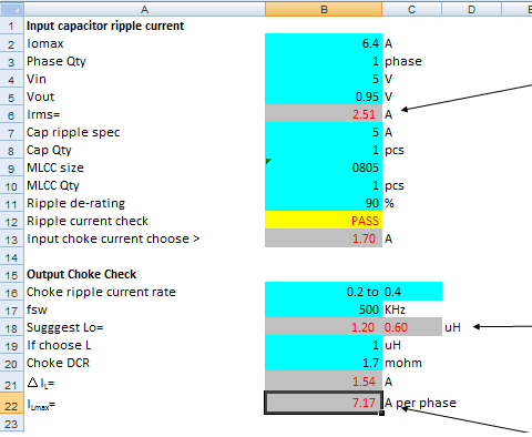

The real TPS54620 application parameters are shown in Figure 2 as below,

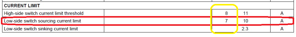

In Figure 2, we calculator the maximum inductor current is 7.17A,
It exceed the minimum current limit 7A show in datasheet,
Please help to confirm have risk to trigger the current in maximum loading?
Thanks!
Vin = 4.75~5.25V, Iout = 6.4A(Max), Fsw = 500KHz, Inductor = 1.2uH

  • No, that is 7 A is the low side current limit.  Your peak current is 7.17 A, which occurs at the end of the on time (high side current limit is 8 A minimum).  At the end of the off time, your current would be 5.63 A relative to the low side current limit of 7 A.  You subtract one half of the ILp-p current from the load current fo the low side limit.

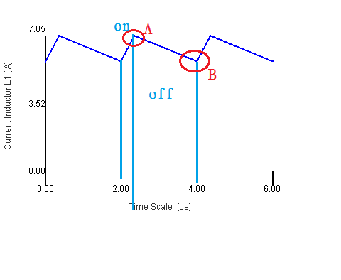

    So, Is the Low side current sensing point B?? (Valley sense??)
    Following waveform is inductor current.

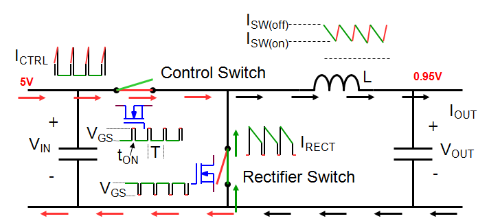

    As following picture.
    When High side turn off, Low side MOSFET current(IRECT) = Inductor current. (Green)
    So, The TPS5462x isn't peak current protect, Right??
    Many Thanks.
  • TPS54620 has both high side (peak current) limit sensing at point A and low side (valley current) limit sensing at point B. There is also low side sinking current limit for the case when point B is negative.
