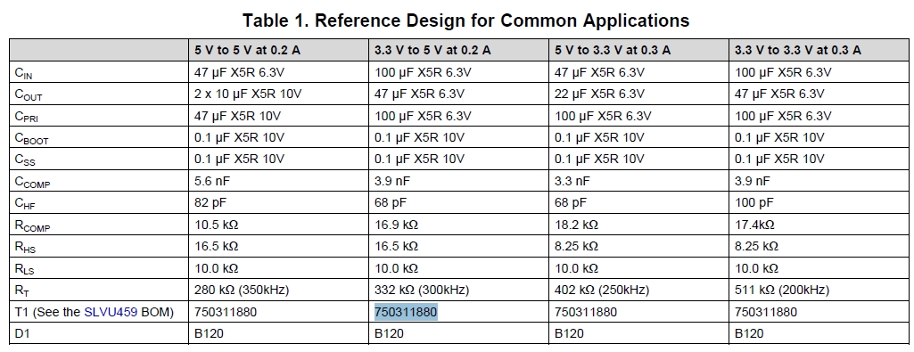

TPS55010: Transformer for 3.3V to 5V/0.2A Flybuck
Part Number: TPS55010
I found the height of transformer for 3.3V to 5V (750311880) is higher than my requirement. Could you recommend a lower one with ~8mm heigh?
Thanks.
