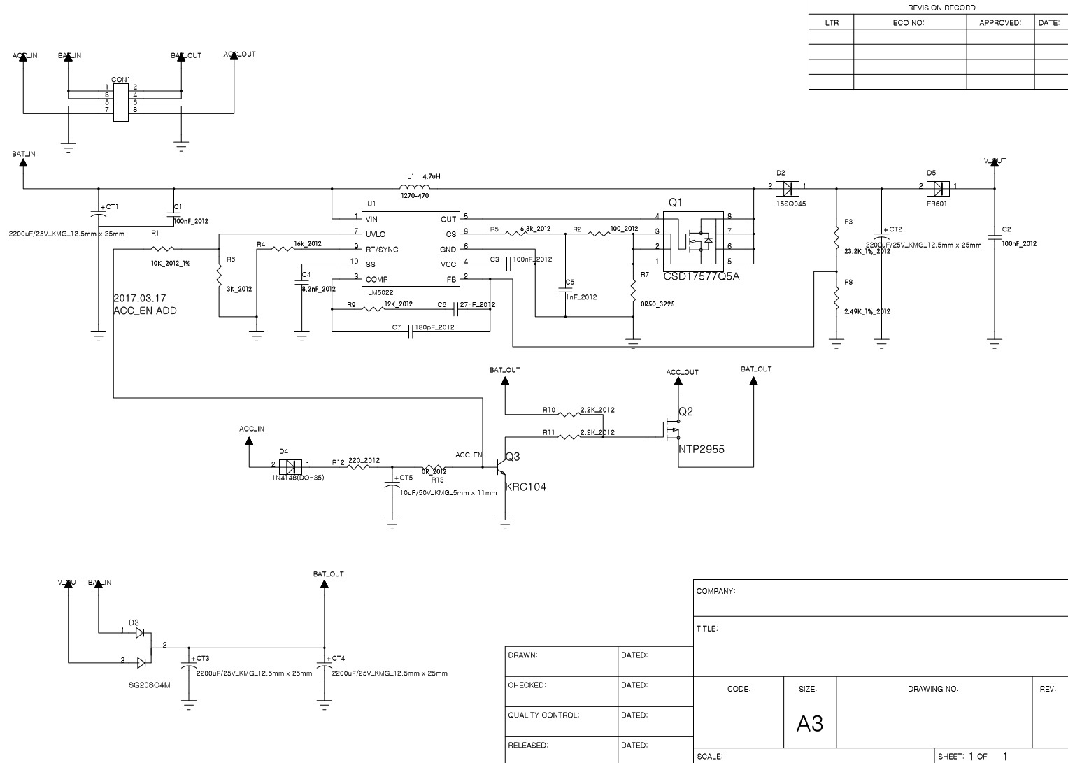

We confirmed the simulation of LM5022 with WEBENCH Designer with Vin6 ~ 12V / output voltage 13V consumption current 6A.
Webbench designed the following methods.
1. Vin (min) 6V / Max 6V --> Vout 13V / Iout : 2A
2. Vin (min) 11V ~ 12V --> Vout : 13V /  Iout : 6A
We designed the attached circuit by combining the above two designs and performed the test.
I tried to implement the circuit, but only about 2A current was driven.
Could you give me a circuit review?
The specifications we need are Vin 7V ~ 12V / Vout: 13V / Iout: Max6A
