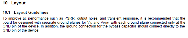

I want to check about PSRR and noise density.
The data sheet has the following description.
Is there a comparative document on whether or not recommended layout is done?
Or, what is the difference as a value?
  • I am not aware of a document that specifically compares different layout techniques for LDOs; however, this is based on the general theory to prevent AC signals from coupling through the ground plane via the input capacitor and output capacitor.
