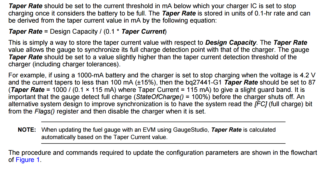

I am designing a device that monitors battery voltage with BQ27421-G1A. I have 2 questions one related to Taper rate value and another about BIN-input.
1:
I would like to know detailed theory of how to calculate “Taper rate” value correctly.
2:

    about issue #1:
    I have an application where charging IC stops charging based on charging time rather that charging current. Final charging current might variate depending on temperature, system load and battery aging. Estimated taper current on my application is 5 mA. So calculations looks like following:
    Taper current (15% tolerace added): 5 mA * 1.15 = 5.75 mA
    Design capacity: 2600 mAh
    Taper Rate: 2600 / (0.1 * 5.75) = 4522
    However BQ27421 allows Taper Rate value to be something between 0 and 2000. What kind of a problems I will have when actual Taper rate is so much higher compared to what can be stored to BQ27421 registers?
    Does anyone have comment to taper rate issue?
  • 5mA taper current is extremely low for a 2600mAh cell. It's not possible to configure the gauge for the corresponding taper rate.
    There won't be a lot of problems because there's so little capacity pushed into the cell between charge termination at let's say 10mA vs. 5mA that the gauging impact should be negligible (e.g. if it sits there charging for another 2 hours at an average current of 7mA then that's just 14mAh vs. a capacity of 2600mAh).
