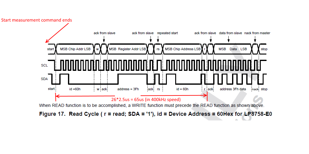

Could you tell me the time until the device reads the current value of the core and writes the register to the address 0x22 or 0x23(I_LOAD_1/2)
after writing the register to the address 0x21(SEL_I_LOAD) to determine the core to monitor the current?
I would like to know how much time I should keep before reading address 0x22 or 0x23.
※Additional information
Since I2C frequency is 400kHz, 1 cycle is 2.5μsec.
Before reading 0x22 or 0x23, are the monitored current values stored in 0x22 and 0x23?

    In order to read the correct current value, I understand that I have to read 0x22 or 0x23 after waiting until the measurement is completed and the data is latched, is it correct?
    Our customer is concerned about whether he can read the correct current when reading 0x22 or 0x23 immediately after writing to 0x21.
    Could you tell me when you know the data latch operation and the time from writing to 0x21 to data latch?
    Yuto Sakai
  • Hi  Yuto-san,
    Yes, you have to wait until data is latched.
    50us from measurement start command end should be enough to guarantee  that data is latched before read command end in 400kHz I2C speed.
    After measurement start command ends, following read command takes 26 clock cycles (stop and start, Chip ID plus write bit, register address, repeated start, Chip ID plus read bit). In 400kHz speed this means 65us which is longer than specified 50us measurement time.
    To be sure data has been latched before reading you have to setup interrupt regarding iload measurement and read interrupt if it is set or not before reading load current value. Based on the explanation above there is enough time for measurement I would not see necessary to read interrupt status.
