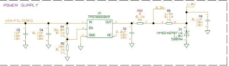

Please find the attached schematic for the reference.
We have requirement of providing 1.8V reference to one of our circuit. so we used Zener in place of reference but the zener is not maintaining 1.8V constant output. The zener part is from ON Semiconductor. we are identifying for a below solutions:
1) Zener diode with 1.8V output, (SOD-123)
2) DC-DC linear regulator with dual output -3.3 and 1.8V (SOT23-5)
