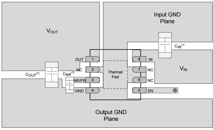

We are noticing some power supply noise and ripples on the outputs due to the drastic changes in current. Please take a look at the attached schematic and layouts. What can we do to optimize the design so the ripple is within 50mV?

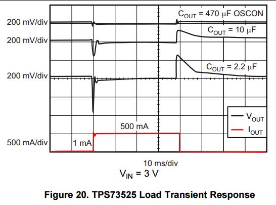

    As with any regulator we only have a few options to improve the transient response at the system level (the LDO transient response is fixed by the internal design of the LDO).  We can reduce the magnitude and/or rate of the transient itself; however, this is often not a feasible option.  This leaves us with adjusting the capacitors.  Increasing the output capacitor will decrease the magnitude of the transient response; however, it will increase the duration of the transient response as shown in Figure 20.
    With regards to the layout there are some best practices that will help your LDO performance.  First it is best practice to have a same layer ground path for the LDO and the related components which in your case are just capacitors.  This same layer ground path should be divided into an input plane and an output plane that meet at the GND pin of the LDO.  This helps to reduce the possibility of coupling through the ground plane from the input capacitor to the output capacitor and NR capacitor.
