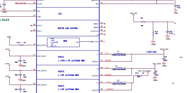

  • Can you share a schematic of the TPS65217D in the application? If the whole PDF cannot be shared, a screen shot of the DC-DC1 output pins would be helpful.
    If the schematic is unavailable, we will need to know the following at a minimum:
    -Value of inductor
    -Total capacitance at SYS pin
    -Total capacitance at VDCDC1
    -Any resistors connected between L1 and VDCDC1
    Some additional questions about the issue you observe:
    -When the voltage goes up to 2.9V, how long does it stay there?
    -Does the spike up to 2.9V happen at start-up or randomly during operation of the circuit?
    -Do other rails also go up to values higher than expected, or just DC-DC1?
    -Is there a battery in the system?
  • Hello Brian,
    Following is the snap shot:
    -Value of inductor - 2.2uH
    -Total capacitance at SYS pin - 39.4uF (10uF x 4 + 4.7 x2)
    -Total capacitance at VDCDC1- 52.1uF (10uF x 5 + 21x 0.1uF)
    -Any resistors connected between L1 and VDCDC1 - NO
    -When the voltage goes up to 2.9V, how long does it stay there? - It was there until we reboot the system. Unfortunately, when we rebooted, it became 1.35V again and we could not reproduce it
    -Does the spike up to 2.9V happen at start-up or randomly during operation of the circuit? - Only once we could see this. We were not able to reproduce this.
    -Do other rails also go up to values higher than expected, or just DC-DC1? We measured DCDC2 which was normal (1.1V) and DCDC3 (1.8V - we are writing to the PMIC register to make this one 1.8 after booting)
    -Is there a battery in the system? YES. Li-Ion

    I've never seen this issue myself, and there doesn't appear to be anything wrong with your schematic or component selection.
    My recommendation would be to try to reproduce it and determine the stimulus which causes the voltage to spike up. I suggest that you try to think of corner cases which happen infrequently and then re-create these conditions using a combination of power supplies and arbitrary waveform generators.
    If you can determine the cause, then I would recommend you try to reproduce it on multiple PCBs.
    Unfortunately, if you experienced the problem and cannot reproduce, it would be quite difficult for me to reproduce it.
