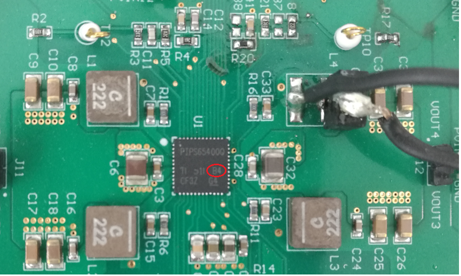

  • Hi, Richard
    See the B4 maker as below.
    I remember the B3 version has some issues, but not sure it is this issue.
    So please confirm the version firstly, and then check the setup.
  • Zhao,
    Here is a picture of the chip on his board.
    This looks to be different form the chip on your board.
    Should he replace the chip?
    Let me know what the customer should do.
    Thanks for your help with this!
    Rochard Elmquist
  • Zhao,
    For some reason the picture did not load. Here it is again.
    Richard Elmquist
  • Hi Richard,
    Zhao is on vacation for Chniese Dragon Boat Festival, I just helped to check the version B, it is same as Verision B4, so they should have the same behavior.
    As zhao's EVM testing before, when ENABLE_PIN_CONFIG=inactive(01) and ENSW1~4 pin are tied to GND, all bucks can work normally, which indicates that ENSWx are ignored aftere ENABLE_PIN_CONFIG is set 01(inactive), so the function should be OK. I guess it should be related to the configuration.
