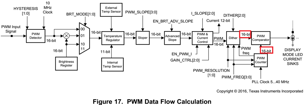

My customer would like to make sure whether Fig 17 is correct if I compare it with the specification on P9.

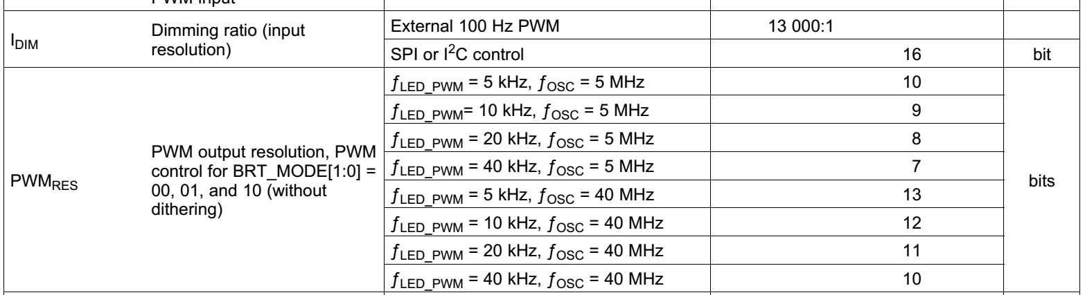

Fig 17 says that the 16bit resolution at the end of flow, however if I check the specifications on page 9, it seems maximum resolution is 13bit (typ).
Can you help me to understand how these numbers work?

    16 bit is total width of supported resolution at PWM output block not calculated from sample CLK freq/PWM freq.
    LP8860 has dithering function on PWM out up to 4 bit. So if actual PWM out resolution from sample CLK freq/PWM freq is 12 bit, it can still support 16 bit. If actual PWM resolution is 13 bit, max 16 bit resolution can be supported by using 3 bit dithering. For sure, input resolution should be 16 bit to get 16 bit output.
