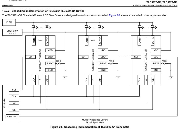

Please let me know if TLC5927 can be used with Cascading Implementation. I believe that it can be used but I'm asking it because there is no Cascading Implementation of Schematic though it's in TLC592x-Q1 datasheet.
