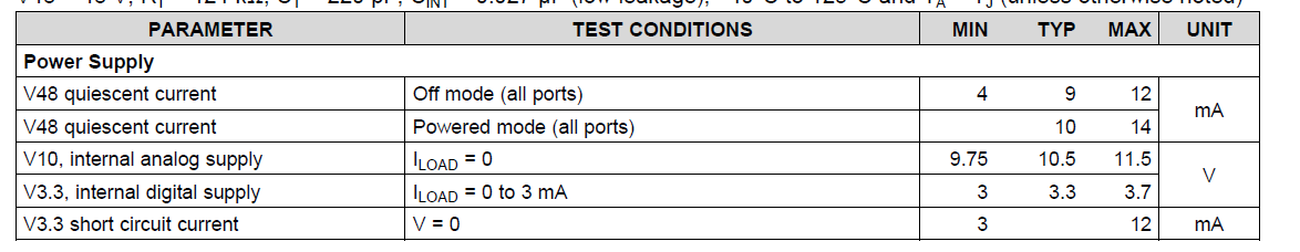

For one of our new project, we planned to use TPS2384 as a POE to interface a Handset.
We are now calculating the power consumption of POE during Sleep mode, Standby mode and Active mode.
Also, We need the loss of power in the cable due to line loss/line drop (Our RJ45 cable will be about 20meter)
Kindly help us to find the above said values. Thanks
Thomas TJ.
  • You can calculate the TPS2384's power consumption based on electrical characteristics table in datasheet(Pvpwr+Pv3.3+Pport). depending on the current of each mode.
    Regarding to the cable loss, it depends on the current and resistance of the cable. For a 100m cat 5 cable, the resistance of 2 pair is 12.5Ω. Thanks.
