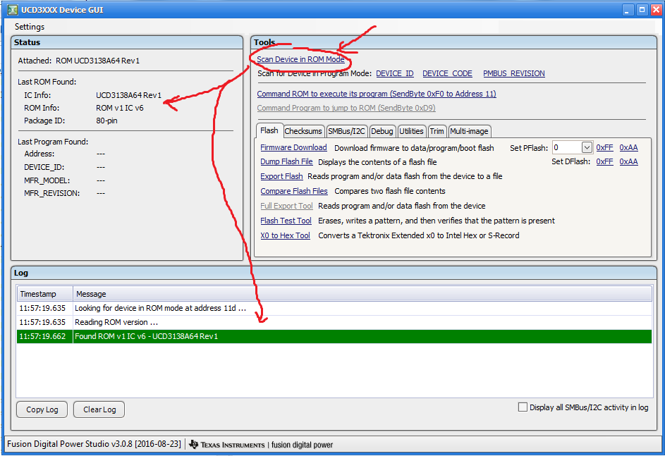

With this configuration the UCD3xxx Device GUI is able to detect a device in ROM mode, showing its type, ROM version and package.
Next, I can start "Firmware Download" in Flash tab, opening the window to download the firmware, where I choose the radio button to stay in ROM mode. This produces the following log:

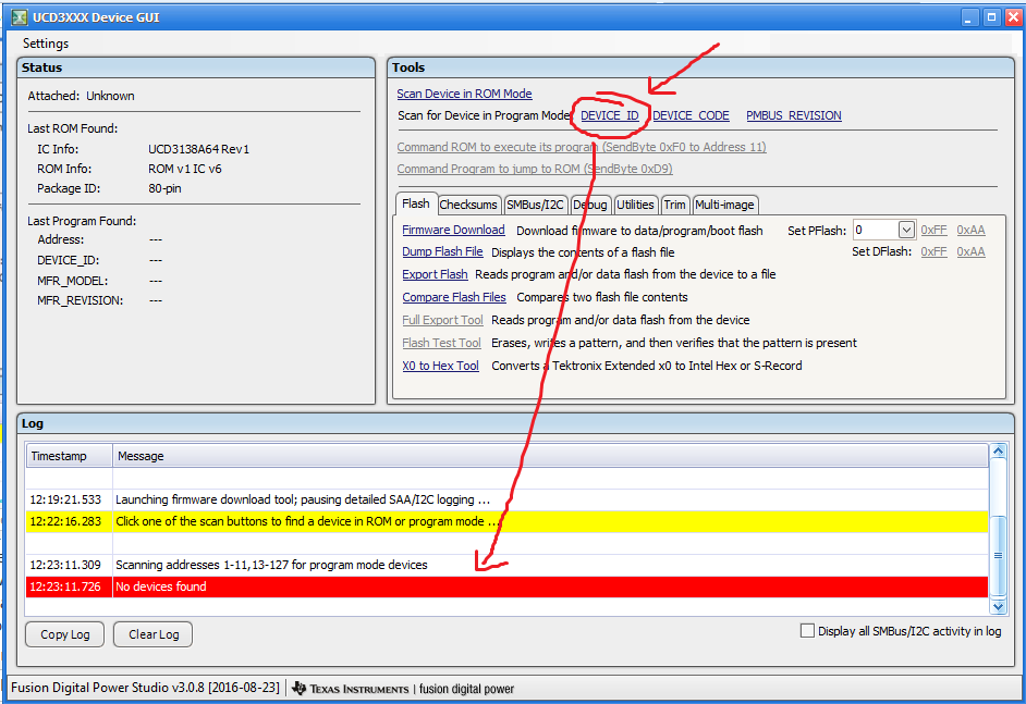

2017-05-30 12:20:32    Scanning for programs that respond to a DEVICE_ID read ...
2017-05-30 12:20:32    Looking for device in program mode ...
2017-05-30 12:20:33    No PMBus devices responded to a DEVICE_ID request
2017-05-30 12:20:33    Checking if ROM is still present ...
2017-05-30 12:20:33    Reading Dev ID Register  ...
2017-05-30 12:20:33    ROM v1 IC v6 detected
As it can be seen, there is no device that would respond to DEVICE_ID request. This can be confirmed from the UCD3xxx Device GUI by scanning for DEVICE_ID.
Please, help me with this problem. Can this be an issue with Code Composer, with the adapter, the eval, the application or the chip itselfs? My bet is that some software is guilty in this case. What else can I try to check it?

  • Hello Adam,
    After you click "Scan for device in ROM mode" you can click "Command ROM to execute its program".
    Amiel
  • Hi Amiel,
    yes, I did that, it had the same effect as scanning for DEVICE_ID: no devices found.
    Because the device responds being in ROM mode and allows to write its flash with verification, I assume that the device is operational.
    I also think that the problem is due to something very fundamental (in other words, a "stupid error"), but what could this be?
    Maybe there is a difference in handling PMBUS? Am I using wrong software?
    Adam
  • Adam, have you connected the Fault 3 pin to ground?  There's a backdoor checksum clear and reset that will occur if Fault 3 floats high:
     // IMPORTANT: READ BELOW, OR CODE MAY NOT EXECUTE CORRECTLY
     // tie pin FAULT3 to ground for normal operation
     // tie pin FAULT3 to 3.3V to clear checksum
     if(GioRegs.FAULTIN.bit.FLT3_IN == 1)
      clear_integrity_word();
    I miss this sometimes myself.
  • YES! Thanks, Ian, that was it!
    The funny thing is that actually I remember about this backdoor... but that's not enough to realize that putting this jumper on is necessary.
    Adam
