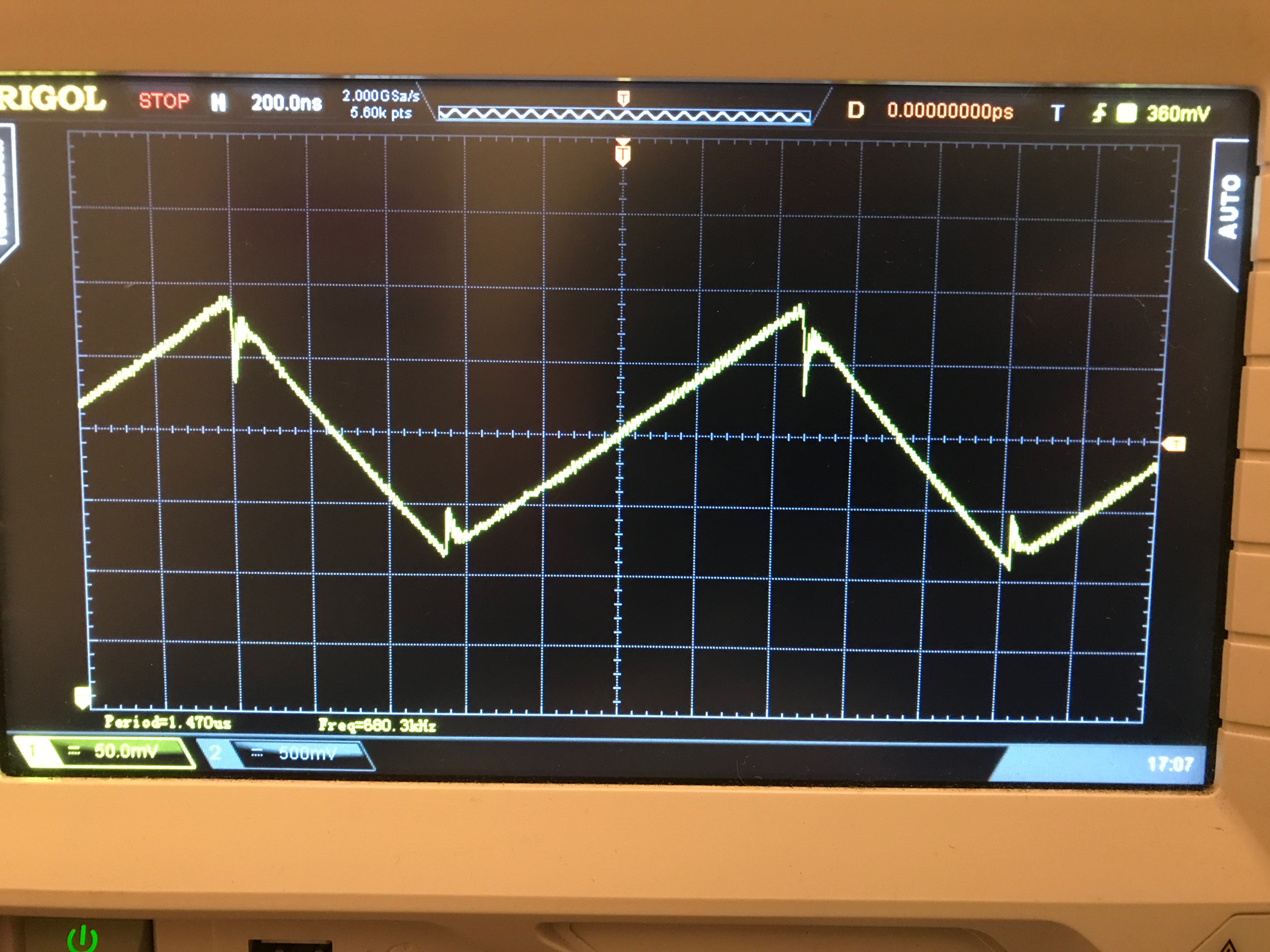

  • Here is the waveform at the ISENSE pin in case it helps.
  • That waveform looks clean so I doubt it is layout related. Do you know what the average value you are reading is? I can't see the ground point for the waveform. How is it that you are measuring the LED current? Are you by chance measuring input current?
    Clint

  • The peak is just under 300mV, and the average is around 200mV.
    I am just reading the current from my bench power supply.
    Derek
  • Hello Derek,
    I see, the input current from your power supply will not be the same as the LED current. The input current will be approximately the LED current multiplied by duty cycle. In this case the duty cycle D = 15.29V/24V which is 0.637. So if you set the LED current to 0.65A you will get an input current (reading from your power supply) of around 0.65A*0.637 which is about 414mA. So your LED current is likely correct and can be measured by taking the average ISENSE voltage and dividing it by the current sense resistor value.
