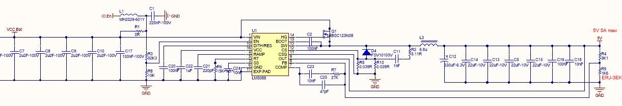

Hi everyone,
I am using the LM5088-Eval Board. When i exceeded to 7 amps , the output is not limited. The hardware i developed using the same reference design works the same way.
I think current sense is not working.
What is the problem? Why can not i limit the current ? I am adding my hardware. I want to limit to 5 amps.
