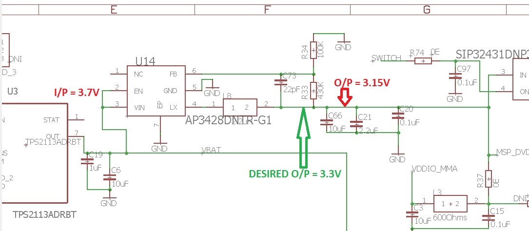

We have designed a circuit using "AP3428DNTR-G1". Our desired output is 3.3V but we are getting around 3.15V.
Here are the supporting components part numbers:
Resistor 430K = ERJ-1GEJ434C
Resistor 100K = ERJ-1GEF1003C
Inductor 2.2uH = NRS2012T2R2MGJ
Please let us know the error in design or component selection.
