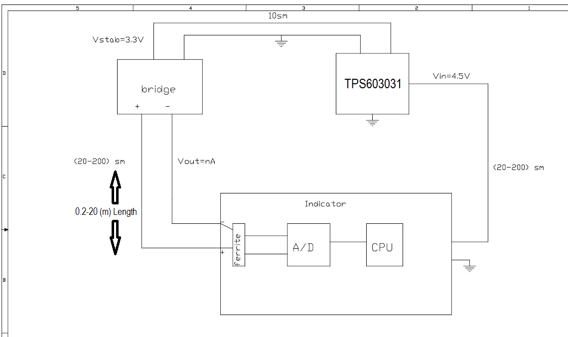

my customer has done design with TPS63031 (in the past they use our TPS61xxx and right now there is the need of buck-boost solution) , the schematics goes as the following :
3.7-4.2V Vbat --> Ferrite Beads (BLA2ABD471SN4D) --> TPS63031 --> 3.3V goes through Wheatstone bridge --> then goes through a cable (which can be length of 0.5-20 meters long) to Indicator.
The problem is the Indicator provides different results in different sizes of cable length which is not appears when used TPS61xxx regulator.

  • Hi Sabrina,
    I'll describe again the problem the Indicator provides different results in different sizes of cable length because the use of TPS63031 .
    Please note that when they use LP38690 (instead of TPS63031) in their old design with the same setup, the problem was not appears.
    4.5 Vbat --> Ferrite Beads (BLA2ABD471SN4D) --> TPS63031 --> 3.3V goes through Wheatstone bridge --> then goes through a cable (which can be length of 0.2-20 meters long) to Indicator.
    Please find below the current block diagram:
    All capacitors are ceramic with the recommended parameters as shown in the datasheet,
    Please can you advise back asap what could case this problem and how to overcome it?

  • 1. Could you capture the waveform:
    - at the output of the TPS63031 before the bridge?
    - At the end of the cable for different length? for ex. 0.2, 10 and 20meters
    2. What is sm?
    3. What measurement is the indicator providing? (voltage, current...etc)
    4. The usage of PS/SYNC pin is described in section 8.4.3 p. 9 of the TPS63030 DS
    The LP38690 is a linear regulator, not a boost converter. Unlike the TPS63030, the LP38690 has SNS that allows remote sensing and eliminates the voltage drop across the cable (description p3 of the LP38690 datasheet).
  • Hi Sabrina,
    After a conversation with the customer, the problem is resolved (partially),
    As I mentioned at the beginning the power flow goes as the following:
    It turns out that ferrite (BLA2ABD471SN4D) created a problem when my client removed the ferrite from the prototype the Indicator did not show any wrong results
    But my client needs this kind of filter before the bridge,
    Please let me know your professional opinion, why adding ferrite (BLA2ABD471SN4D) to the design can causes such a problem and how to overcome it?

  • I assume the voltage drop across this filter has changed. Can you measure the supply voltage at the Wheatstone bridge using an oscilloscope with and without the filter?

  • I was asking for more data to better understand the problem. If the problem is related to noise generated by the DCDC converter adding an LDO will make a difference. If the problem is related to limitation of the available power the LDO most likely will make it worse.
