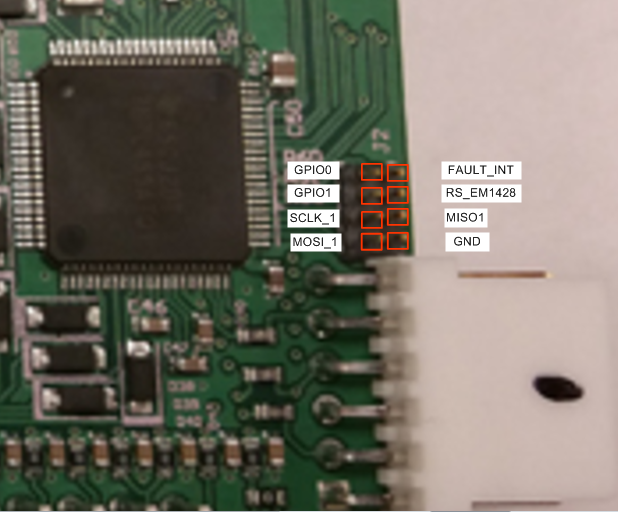

    I'm trying to make a connection between the EM1402EVM and the TMS570.
    On the EM1402 I am having difficulty making the connection with the J2 (stated on the board itself) and stated as J6-1 on the instruction sheet. In understanding that the J2 is the correct connection to the launchpad then what would be the correct pattern of the 8 pins? In what order would the pins read?
    Thank you.  Noel
  • Hi Noel,
    Hopefully this image helps, if i am understanding correctly.
