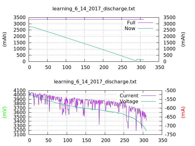

I am trying to configure the BQ27441-G1A for a new larger battery (2900 mAh). I have previously had this working with a smaller battery using the default settings.
Based on the quick start guide, it appears that I only need to change 4 register values for this to work.
I followed the pseudo code example in the TRM, section 3.1 (pg 14) "Data Memory Parameter Update Example", to create a bash script (attached) to update these registers.
I have set the 4 parameters using this bash script:
Design Capacity = 2900 mAh
Design Energy = (Design Capacity) * 3.7 = 10,700 mWh
Terminate Voltage = 3200 mV
Taper Rate = (Design Capacity) / (.1 * (Taper Current)) = 98 (.1 Hr rate)
I tested the larger battery with the default values in the BQ27441-G1A, and with the updated values. I am now having problems with the battery gauge accurately reporting the battery percentage. In our tests the battery is jumping from 92% to 100% charged, and then during discharge the battery is dying while still reporting between 17 - 30 percent remaining.
Is there another step to programming the fuel gauge that I missed?

  • Have you updated the Chem_ID (You're using a new battery) followed by a successful learning cycle ?
    Chem_ID: http://www.ti.com/tool/GPCCHEM
    Learning Cycle: www.ti.com/.../slua597.pdf
    Check out those links. Having the correct chem_id match (or close enough), and successful learning cycle is essential to having a proper working
    IT fuel gauge.
    Hope this helps,
  • The Learning Cycle paper that you linked to references the command IT_ENABLE, which is not mentioned in the TRM for this chip. This paper also references a QEN Flag bit, which is not present.
    How do I begin the learning cycle?
  • Hi Jarrett
    Pls use this app note instead. the 441 has IT enabled by default. it is never turned off.
    4857.1586.LearningCycleOverview_bq274xx.pdf
    thanks
    Onyx

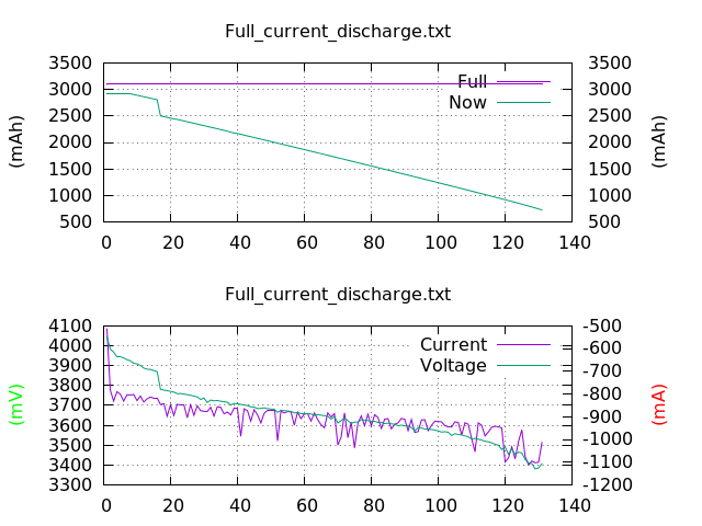

  • Hello, I performed a learning cycle . However, when I attempted to do a full charge and discharge with my unit at it's full current draw the battery died while the gauge was still reporting 17% battery remaining. Have you seen this before? I have attached two graphs of the discharge. Note that the x axis is time in minutes.
  • Jarret,
    It wouldn't be unusual for a burst of current to crater your battery causing it to go down to the terminate voltage you programmed in your data flash. Since truee FCC is dependent on current, due to the IR drop due to the internal resistance of the battery, the SOC can drop to empty if you have a large current draw occur closer to the end of discharge of the battery.
    thanks
    Onyx
