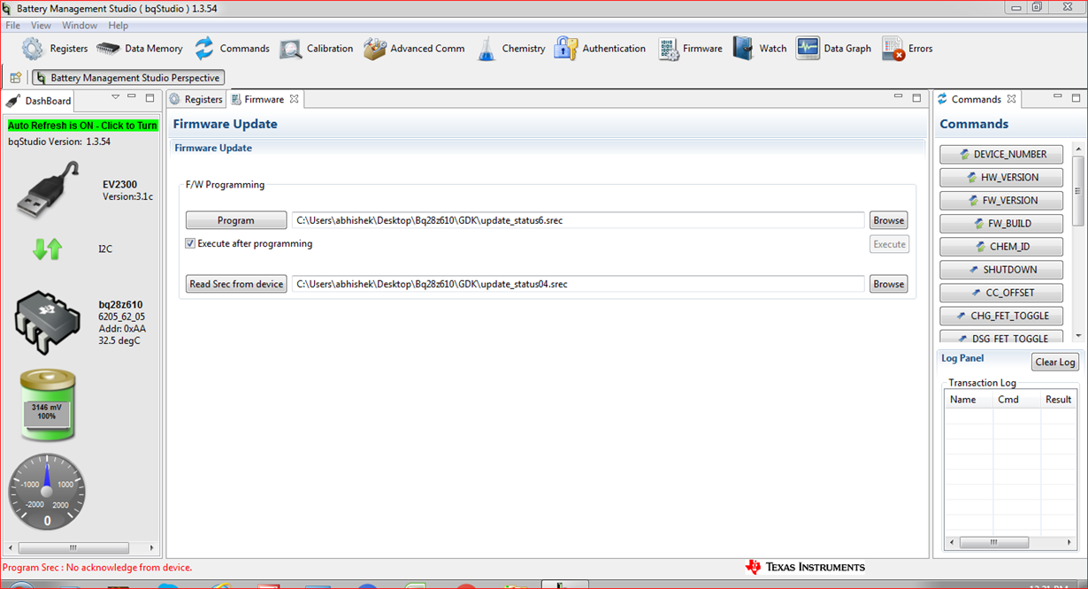

  • Hi  Onyx ,
    Perform learning cycle, got update status 0X0E.
    1).Can I use this srec file as the Golden image?
    2).I tried to write  srec file from learned gauge to new gauge out of 5  in two I  can write successfully. With other three I am getting acknowledgment is not received from the device only during programming. These are device which I power up earlier and the battery was connected so the battery is getting charged and discharged without setting proper parameter. Kindly suggest how I can resolve this.
  • Hi Onyx ,
    Solved second issue not doing UNSEAL FULL ACCESS, able to sucessfully program one more board , other two boards are not getting connected with BQstudio at all, one board got connected once after that it is not getting connected.
  • Ensure that your battery voltage is high enough, >3.4V. Also, i suggest updating the firmware on your ev2300. I see you are using version 3.1c. You should be using version 3.1m or 3.1r. Also, ensure to press the wake up button or connect a voltage on pack + to wake the device from shut down mode. If you are unable to communicate with a device, you might be in ROM mode. Uncheck the "execute after programming" field and click the execute button to exit ROM mode.
    hope one of these proposals helps.
    thanks
