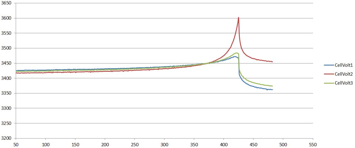

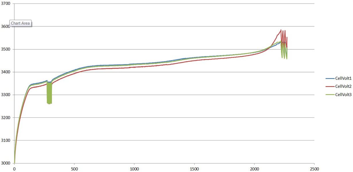

I am using bq24650 charger along with bq40z50-R1 for charging and management of 3 series cell LiFePO4 pack. Towards the end of charging, one cell voltage shoots up due to imbalances in SOC and then triggers Cell Over voltage protection. All the balancing arrangements I have seen and tried, takes hours to balance the cells, whereas this overshoot happens in seconds or minutes. Is there any way to tackle this issue ?
