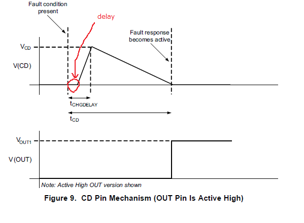

Looking at the data sheet in Figure 9, after OV is detected, the capacitor connected to the CD pin starts charging.
However, it seems that there is a little time before charging of the capacitor starts, as indicated by red in the attached figure.
Is there really a delay time like this little time?
Or is it only the delay of internal logic? In the case of internal logic delay, how long will it delay?
