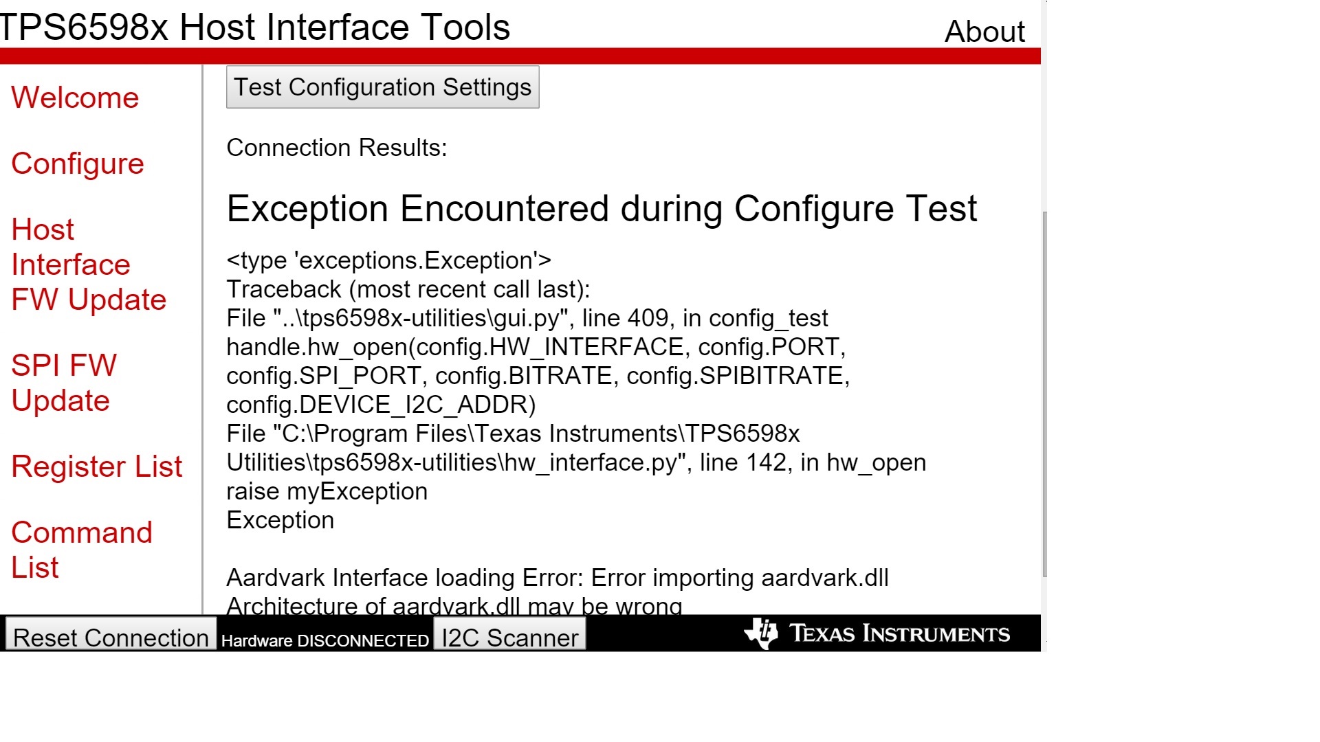

3. I try to update FW by  TPS6598x Utilities GUI, but  it show below error  message when I click "Test Configuration Settings. How to fix it?
Thanks!

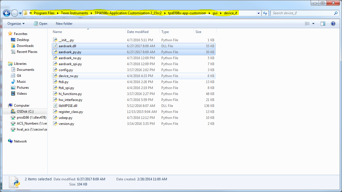

  • Hi Otto,
    Can you confirm that you imported the "aardvark.dll" and "aardvark_py.py" files into the correct location? Please follow the steps in section 3.1 of the app customization users guide:
    You should paste them into the correct location as highlighted in the image below:
    Thank you,
    Eric
