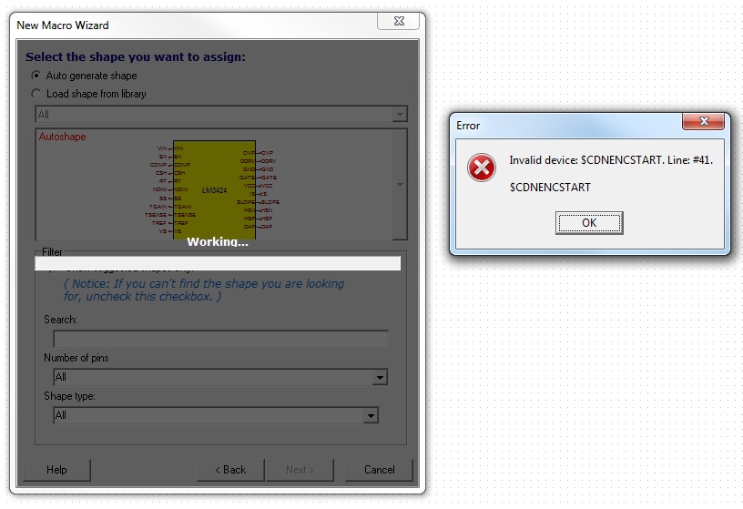

Part 1)
I'm trying to import LM3424 Pspice model and have not been successful. Tried to import macro and its throwing error "  Invalid device : CDNENCSTART. Line #41". Please suggest how to import the Pspice , this was downloaded from TI - LM3424 part webpage

  • Hello CV,
    To answer your questions:
    1. Most people that monitor this forum are from a product line and do not have knowledge of pspice or TINA-TI coding or importing. You would probably have better luck posting this question in the "Development Tools" forum.
