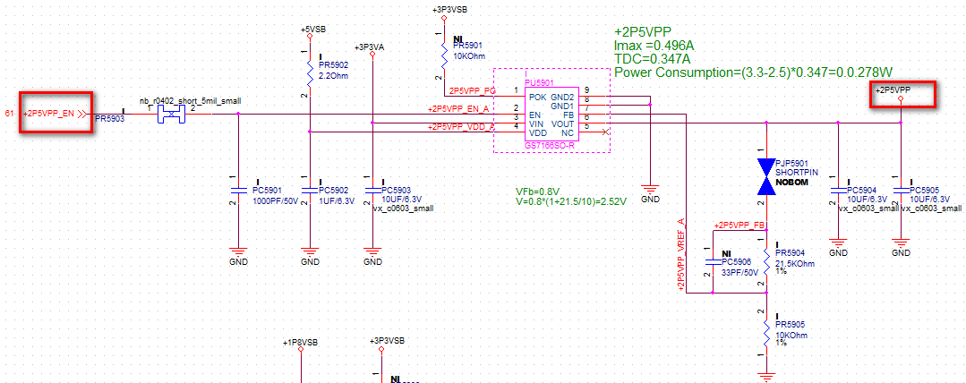

  • Hi Jay,
    THe original customer design is described as below.
    • ENB is from SLP_S4
    • VSB is from the 2.5V load switch enabled by PGB (load switch's input is from VR5 output)
    • ENVR2 is from SLP_SUS
    Now they told me the original issue is not seen if either modification as below is made:
    • Case1 : Adding 50ms delay on SLP_SUS
    • Case2: Change the 2.5V load switch input from VR5 output to LDO5V

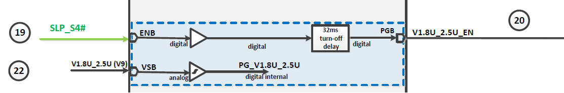

    Can you explain why the issue not seen in either case as described above?  Besides, i still don't fully understand regarding " There is 32ms delay between VSB and PGB signal" and how it affect this issue.  Can you explain with more details?
    Thanks!
    Antony
  • Antony,
    PGB is enable signal of the load switch 2.5V. If SLP_S4# is disabled, there is PMIC internal delay of 32ms for PGB to go low. If SLP_SUS# is disabled, VR5 rail is disabled.
    In customer case, if SLP_S4# signal and SLP_SUS# signal are disabled together VR5 is disabled but PGB is still high. On the load switch, input (VR5) is disabled and enable signal is high and VSB pin does not sense any input and PMIC goes to emergency shutdown.
    Case1: If delay is added between Sleep signal, this problem is avoided and you do not see a fault
    Case2: As LDO5V is always on, if PGB is on for 32ms longer, this will not create any fault.
    Hope this helps.
    Jay

  • Hi Jay,
    Additionally, can you suggest which way is better as listed below?  Are they all workable solution for this issue?
    1. Delay SLP_SUS# for 50ms,and change VSB connection to be from VR2
    2. Change +2P5VPP load switch (for VSB) input from VR5 to LDO_5V
    3. Supply VSB by VR3 output by adding resistive divider
    Thanks!
    Antony

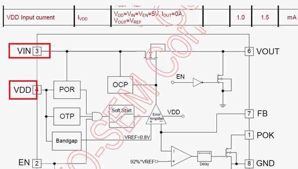

  • Hi Jay,
    Regarding options, they actually connect LDO5V to the VDD pin of the LDO as below.  So, it only consume 1.5mA max.  Do you think the current consumption here is still be a concern?
    The other concern is, they will connect this LDO output (2.5V) to VSB.  Currently it works ok.  Is it really necessary to add a resistive divider to generate 1.8V for VSB?
    Antony
