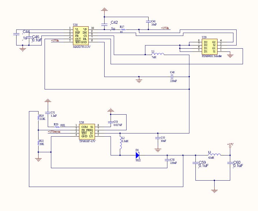

My design is  based on figure 14 of TPS61087 datasheet and the input voltage is 3.3V
But TPS61087 can't generate 15V output, only 10V is generated.

  • Please check the attached files for my design.

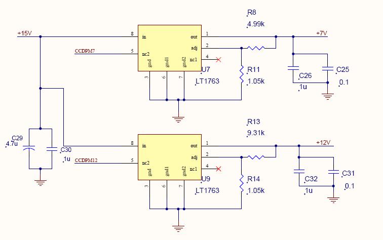

    The 15V is going to feed two LT1763 LDO chips located on other board.
    On my test, i have disconnected those two boards, and TPS61087 can't generate 15V.

    How did you base your circuit on Figure 14 in the datasheet?  Figure 14 shows a circuit that converts 5V to 15V and runs at 1.2 MHz.  Your circuit is converting 3.3V to 15V at 650 kHz (FREQ is grounded)--so figure 15 is closer to what you want.  But even then, your inductor and output capacitor are different and this will affect things.  If you want to run at 650 kHz, please use the component values recommended in table 3 that show your exact conditions (3.3V to 15V at 650 kHz) or go through the detailed description to select your components.
    Another thing to try is powering the TPS61087 circuit from a known good power supply--a lab supply putting out 3.3V.

    I have used TPS61087 to replace MAX17067 for generating higher current.
    MAX17067 can generate proper +15V output.
    After changing R20 to 91K and C51 to 1.2nF, I have put TPS61087 on the footprint of MAX17067 by connecting pin4 and 5 together, connecting Pin6 and Pin7 together.
    I have tested today again, only 10V can be generated by TPS61087.

  • In my current circuit, I am using 1.2MHZ.
    I have selected those inductor(3.3uH) , resistor(91K), cap(1.2nF) values based on table 3 of TPS61087 datasheet  for 3.3V input and 1.2MHZ frequency.
    This 650KHZ mode is for getting more current.
  • The schematic you posted has FREQ connected to ground.  This is 650 kHz operation.
    Could you post a scope picture of the SW pin, Vout, and Vin?
    Could you post your board layout?

    After reviewing your schematic, I do not see anything that would lead to an output voltage of 10V.
    Could you please recheck the feedback divider and also the current rating of the inductor, please?
    I am asking you this, because normally I do not see any reason for the part to deliver the wrong output voltage. If you are measuring the voltage on the FB pin, it should be far below 1.238V and therefore the part should increase the delivered energy.
    Brigitte
  • it is fixed,  I have resolderedTPS61087 then it is working and I got 15V.
