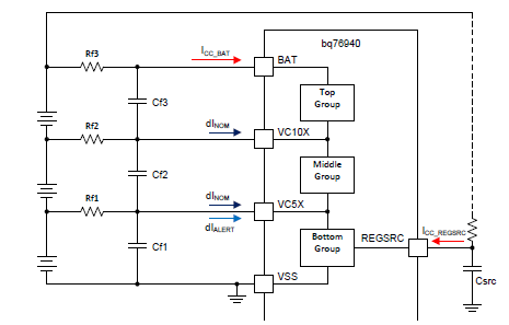

  • Please refer to group currents( dInom,dIship, dAlert, dIcell, listed in the d/s table. page 14.
    the illustrations below will give an explain the branch currents.
    2) typical NORMAL mode( ADC ON , CC ON) =195uA MAX. Likewise other modes like normal mode currents( ADC on/off, CC on /Off are given in table 6.5 of the d/s.
    Ok I got it, but what about the imbalance that the bq76940 causes that I told above?
    Is there a higher consumption of the bottom group? Is it significant?
