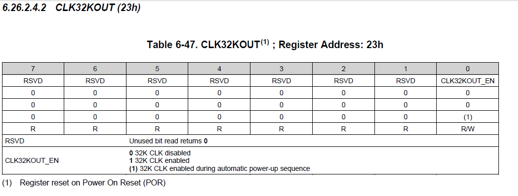

    In the data sheet, the CLK32KOUT register is defined as shown:
    This suggests that the default is 0, however there is a note that the clock is enabled during the automatic power-up sequence.
    To reprogram the registers, the device needs to be on. Once the device is completely off, the registers will boot back to their default values. However, you can enter a sleep mode, where the registers do not loose their programmed settings.
