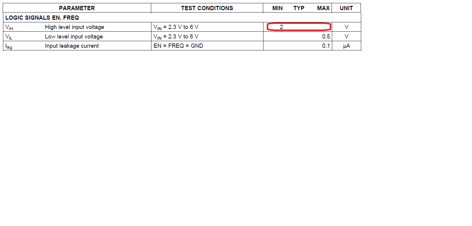

Can I use divider resistance on EN pin to set a new UVLO? Now the UVLO is 2.2V. For example,if I want IC starts after VIN rises to 4V,  can I set a 10K-pull-up and 10K-pull-down resistance on EN ?

  • Hi Hu,
    Please check the following screen-shot: EN signal High minimal value is 2V, this means, when EN is higher than 2V, "all " the IC should startup. so if the customer want to make the IC startup succeessfuly, the EN signal should >=2V.   But some of the IC may startup  at a value low than 2V, we foudn it is 1.7V before.  I'll check with the design team.  if you want to control the startup precisely at Vin=4V, then extra ciruit, like the operational amplifier is needed.
