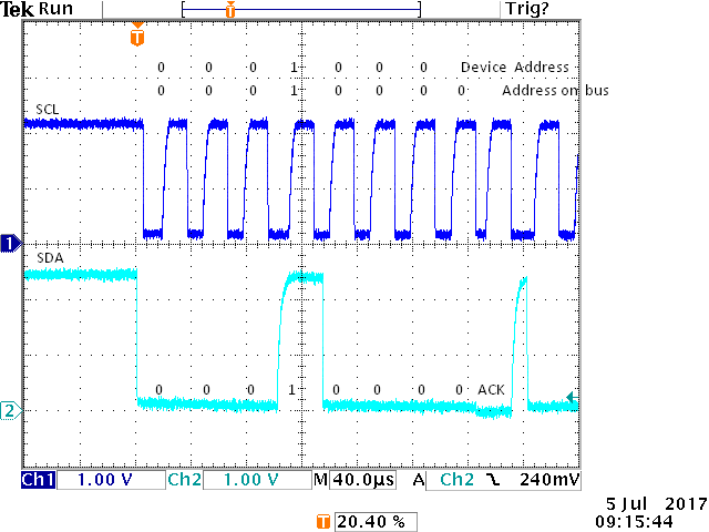

    If the part has proper power it should ACK its address and communicate.  Remember that the address 08 is a 7 bit address, it looks like 10 on the bus as shown below.  Check that the tool for your MCU or peripheral are making the conversion properly. Also check that the levels and edges are ok.  Signaling from the MCU is likely to be much faster than that shown below.  If the MCU does not receive the ACK it likely stops thus leaving the bus signals high.

    I am using 0x10 on the bus for the slave Address. Now, SDA is low and SCL is HIGH and is holding these states irrespective of Releasing of the Bus.

    In general you may need to look at the bus to see who is driving it. If the bq76920 is holding the bus low it may have set the ACK and be holding it waiting for a clock, or may have started outputting data from a read. The standard bus-release mechanism in I2C is to send (up to 9?) clocks until the slave releases the bus. If the host is holding the SDA line it may be a peripheral setup issue.
