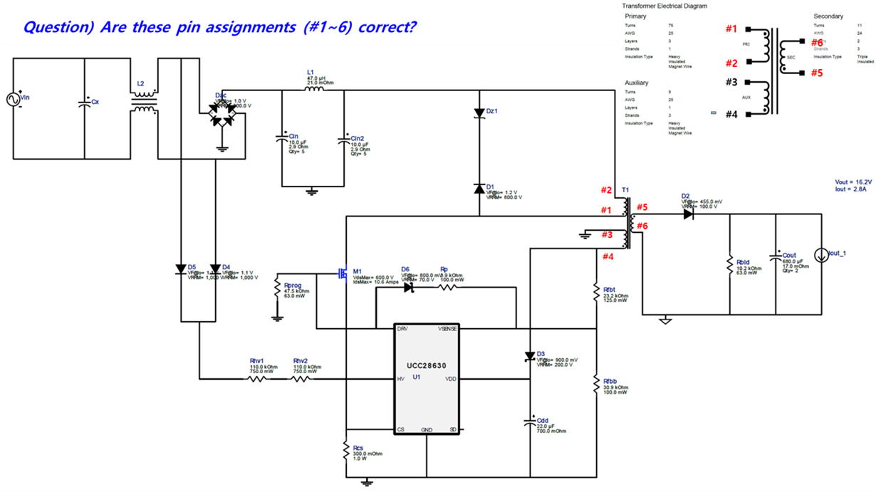

Hi, All.
I'm trying to design SMPS with UCC28630 using the WEBBENCH design tool and have a question about dot directions of transformer.
Using WEBBENCH, we can get a schematic and a transformer report both for a given design, however, as I was using UCC28630, dot directions in the schematic and the transformer report are different as shown in diagrams attached below.
I'm not sure if the dot directions in the transformer report are correct and it is just used in the schematic by changing pin arrangements. Could you let me know where this difference comes and how I have to use it correctly?
  • Kyuate, the dot notations are the same in both of these diagrams. You can see that the dots are opposite the same pin numbers in each case. The pins are just rearranged graphically in the schematic.
    As shown, pins 1, 4 and 5 should be wound in phase with each other.
    Billy
  • Hi Billy. Thank you for the comment. Just for a re-check, how about the case in which the pin numbers were not shown in the diagrams? Are those two transformer diagrams still same? The reason why I'm asking same question is that the pin numbers in the attached diagrams were assigned by myself to explain my understanding on the difference between two diagrams. Thanks!
    Billy

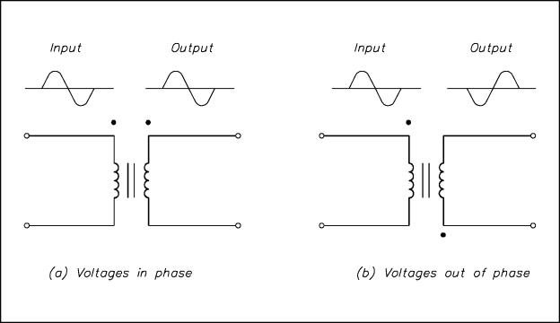

  • Hi Hyutae,
    Thanks for reaching us on E2E, and yes your understanding and labelling was correct. The transformer report downloaded from Webench does not have any pin assignment, it only offers the key transformer parameter for transformer design and manufacturing.  This allows user and transformer manufacturer to have the freedom to select their pin assignment for the transformer, the dots are only indicating which ends would be in phase.
    The dot notation of the transformer is an indication of which ends of the transformer would have the same polarity i.e. in phase. The picture illustrated below gives a clear indication of the dot notation when a sinusoidal signal is applied:
    I hope this would help to clarify your questions.
