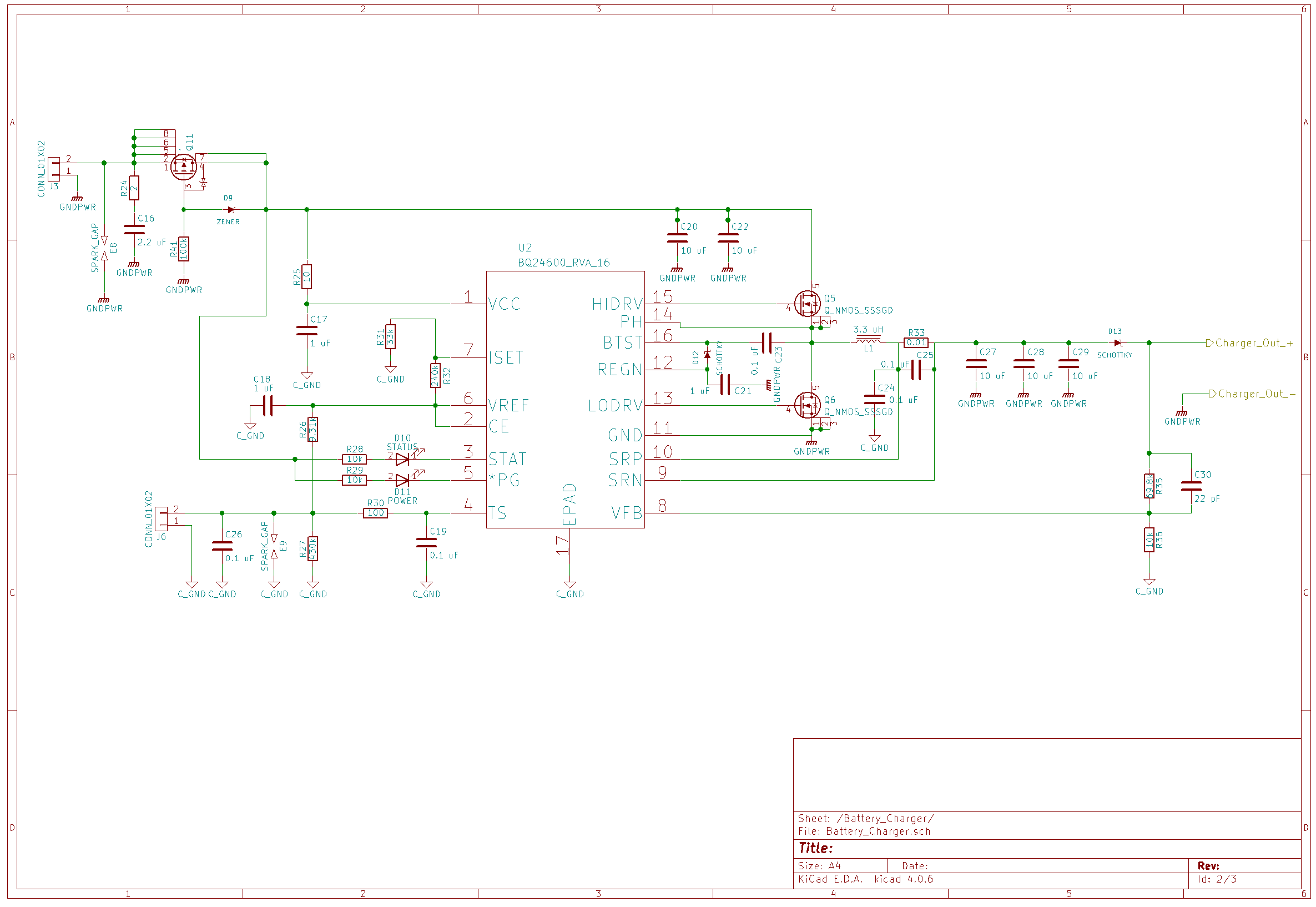

We are building a 4S (16.8V), 2A charger for a LiPo battery using the bq24600.
We had problems with the reference design as per the bq24600 datasheet: The PCB failed catastrophically from high inrush current when the battery is connected. From other post on this form it seems that several other users experienced a similar problem.
We solved the inrush current problem by simply adding a schottky diode (D13) in the output path of the charger as per the attached schematic.
However, our charge current is measured at around 1.7A and not the desired 2A as was designed for.
Thus, will the addition of the output diode affect the internal regulation of the bq24600 to explain the charge current difference? If so, what will be a possible solution for accurate charge current with inrush protection?

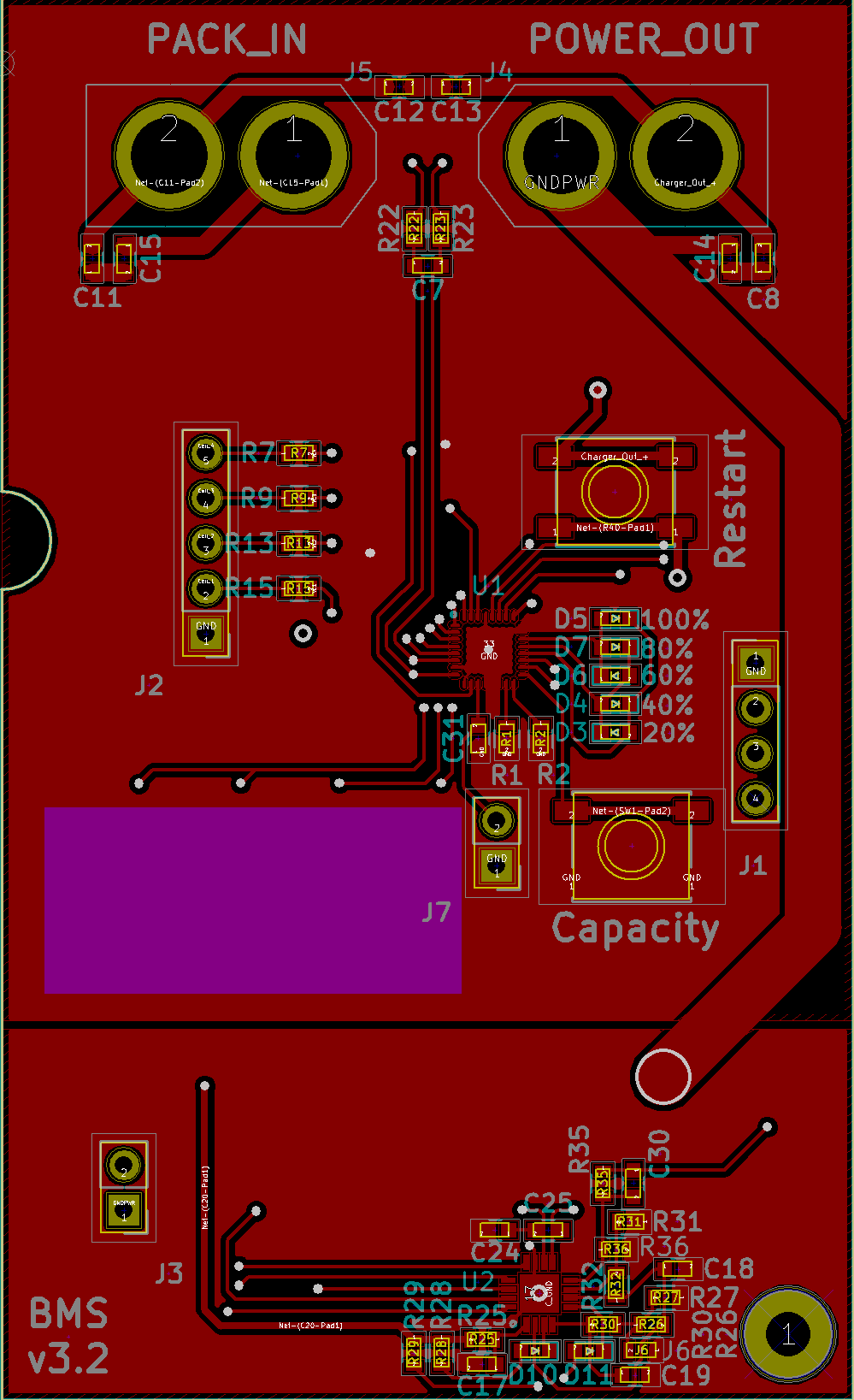

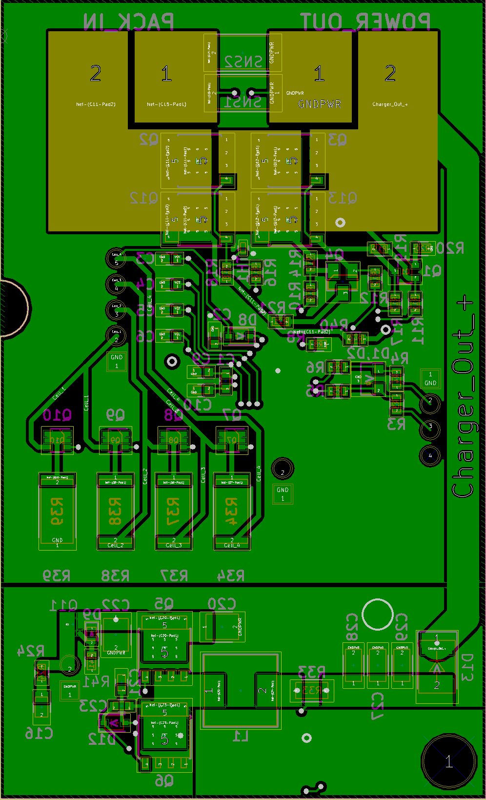

    Herewith attached is the schematics as well as the front and back board layout. Advice on what to check or change will be much appreciated.

    Since bq24600 is external MOSFET solution, It shouldn't has 92 degC on IC. The only bigger power consumption is driving circuit. Could you please help me to check if driving capability is not enough for your MOSFET? or is there any big consumption in your circuit?

  • Hi Jan-Cor,
    It is a little difficult to check comprehensively, but I also observed some point need to verify.
    For your GND routing, GND trace of setting resistor like ISET, TS...etc. are too long. It may influence setting vallue.
    For Vin cap, you can put C20 and C22 together(at C22's position) to minimize the routing between high frequency swtiching loop.
    For REGN cap, please put it as close as possible to IC.
    For your high temperature issue, I want to check if this issue comes from IC or not. Please swap a new IC on the board to see if high temperature is still there. Also check with the impedance on old IC compared with new IC.
    Ann Lien
