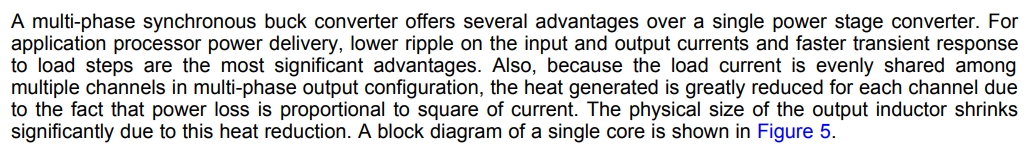

Hi
This device has peak current mode control.
On the datasheet, it is mentioned about the current sharing at each phase.
I understand that the each phase is controlled by peak current mode(ILIM_FWD). However how can be shared the current equally at each phase if it is the multi-phase configuration?
For example, at 4-phase configuration(Buck0+Buck1+Buck2+Buck3=10A:LP87521 version?) how the each phase can be controlled the current equally?
