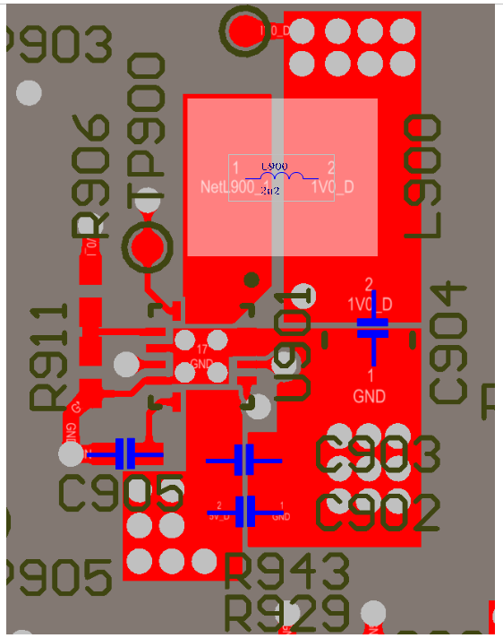

  • Hello Ivo,
    the Layout of the U901 is send by e-mail.
    I can not copy the picture of the layout of U901 in the browser.

  • Hello Robert,
    thanks a lot for sharing the layout.
    The power net routing really looks excellent !
    However one important item is the sensitive VOS pin connection.
    So could you please also share the inner layer trace from FB resistor (R906) to VOUT capacitor (C904) and VOS pin of the device?
    Ivo
  • Hello Ivo,
    thank you for your response. The Layout with the internal connection:

  • Hello Robert,
    thanks for sharing the complete layout. It looks good, there are no concerns.
    I also noticed that FSW is connected to VOUT. With a VOUT setting of 1.0V, the high level will be well detected.

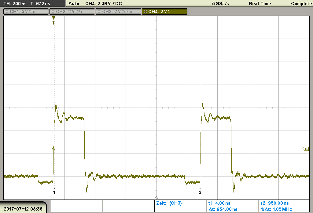

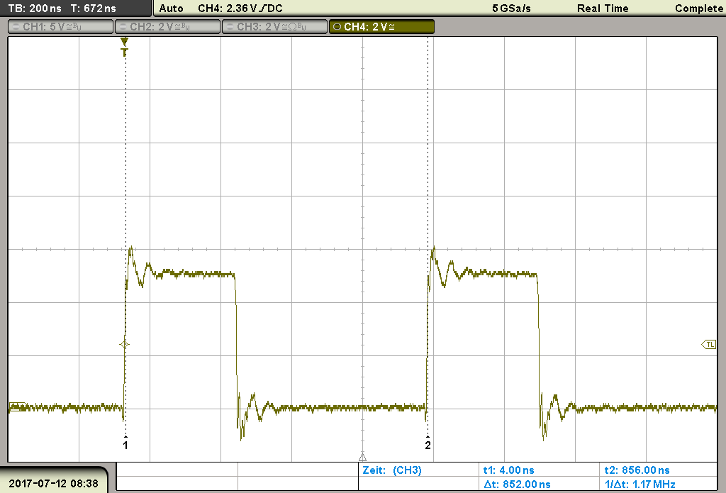

  • Hello Ivo,
    we measured the SW Pin of DC/DC converter 1.0V and 1.8V. The switching frequence should be 1.25MHz: in fact it is 1MHz (80%) an there is a step before he switches to the top transistor.
    The 1.8V looks better: There is no step before he switches on the top transistor, but his frequency is 1.17MHz (93.6%)

  • Hello Robert,
    thank you for the scope plots of the SW node wave form. This looks ok: With VIN < 6V the switching frequency can be lower than the typical 1.25MHz. Also the short negative step is a normal behavior.
    You mentioned that currently a lab power supply is used to power up and down the PCB.
    Hot plugging can create high voltage transients damaging the device.  Please read this blog explaining the phenomenon and workaround by adding a larger tantalum capacitor at the input:   https://e2e.ti.com/support/power_management/non-isolated_dcdc/f/196/p/608918/2243806#2243806 .
