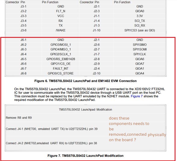

Hi, I have recently bought EM1402EVM and trying to balance 8 cells in series(18650), boards are not stacked, just one board.I am newbie in this. I am connecting it through hercules launchpad. I have gone through users guide to do connections, just confused about 16S cable where to connect(I have shorted all remaining balancing cables after 8 to 8th cable). and another thing Do I have to change all values in Example code for 8 cells? Thanks in advance.

    I went through schematic, U2's 38 and 39 pins are connected to R8 and R9 and further connection goes to SCI1_RX and SCI1_TX resp. So Can I connect J4-1 and J4-2 to SCI1_RX and TX?

    I have made all the necessary modification to launchpad and as well as code, I have connected all the 8 connection for emulating 2nd uart port between EVM and Launchpad mentioned in www.ti.com/lit/ug/tidubi0/tidubi0.pdf .
    Then debugged the code in CCS, still not able to balance cells.

  • Hi Vishal,
    Thanks for all of the information...
    To answer your first post, yes you must physically remove (unsolder) R8 and R9 from the TMS570 and then make the other connections.
