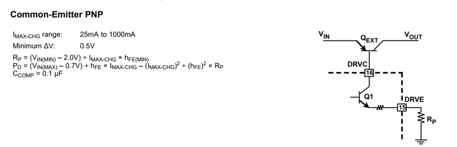

I am trying to understand the equation to calculate value of Rp in datasheet SLUS929C (BQ24450) pages 13-14.
For the first example using PNP drive transistor, the equation is shown as follows:

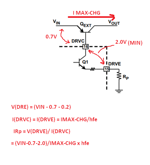

The data sheet mentions minimum voltage drop at pin 16-15 is 2.0V (@25mA max).
So shouldn't RP = V15 / IRp
=(Vin - 0.7 - 2.0)/(Imax/hfe)  [Imax = current through  Qext and hfe= Beta of Qext]
=(Vin-2.7)/Imax/hfe
