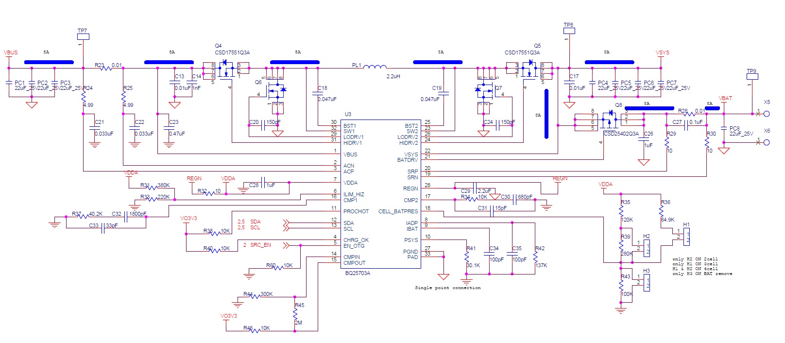

When the chip work under OTG mode, the otg current is set to 3.6A. I set the electronic load to 3A. It works well under OTG voltage is 5V and 9V and it fails under 12V. It works at the beginning but fail after a little later. The voltage keep dropping and drop to 0 at last. When  I enlarge the otg current to 4.2A. It works well under 12V. Why the current limit error is so big? What can I adjust?

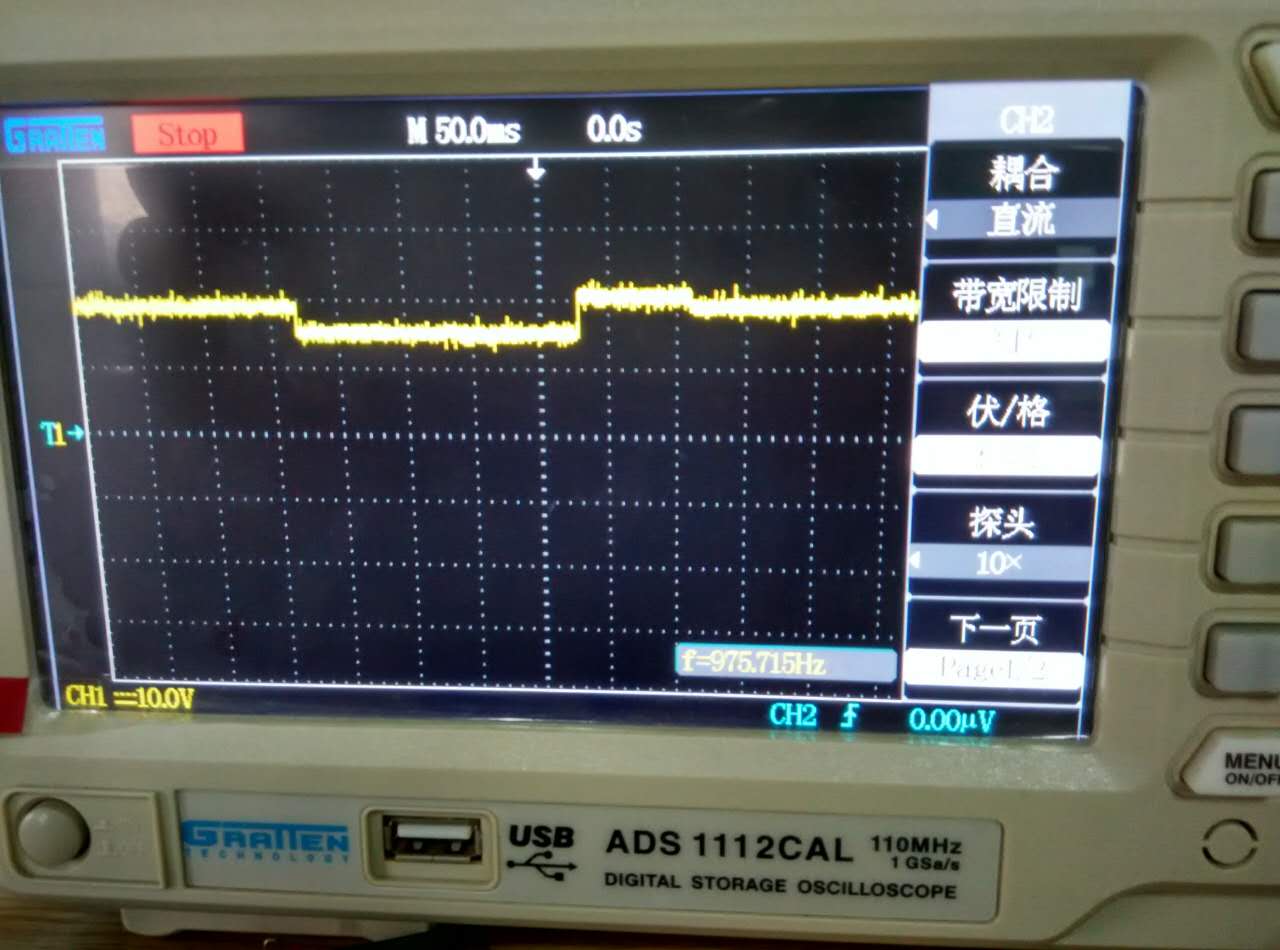

    This is the wavefrom for 4A@20V. At the beginning, it is 20V. It change to this after a while. And at last it drops to 0. I notice the board temperature rise to 100 degree. Is the chip too hot and become unstable?

  • What is the battery voltage? The EVM should support 4A OTG without reaching 100 degree if the battery voltage is not too low.
    bq25703A has a very good charger status to help us debug an issue. Would you check the charger status register? Does it report any abnormal condition?

    I have test the EVM board. It is about 70 degree under 4A OTG mode. When I add the fan to my board, it also works well for 4A and 5A OTG mode. My board size is only quarter of EVM board. I think the heat cannot dissapate fast and then cause the board is very hot. When I obeserve the OTG voltage shift, the SW is already not fixed. The chip works unstable.
    The battery voltage is 16V on my board. This is no problem.
    I found the current limit issue is related to sample resistor. The resistor has a big error.
