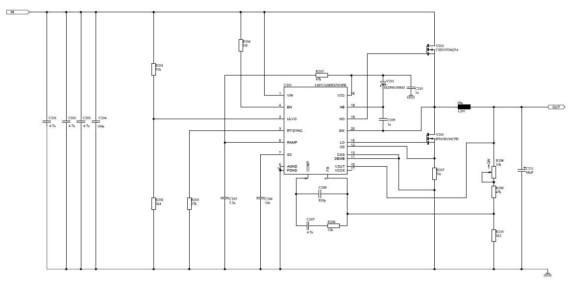

I am using the lm5116 buck converter with the following parameters:
Input: 65...80V
Output: 48...56V/ 5A
Schematics:

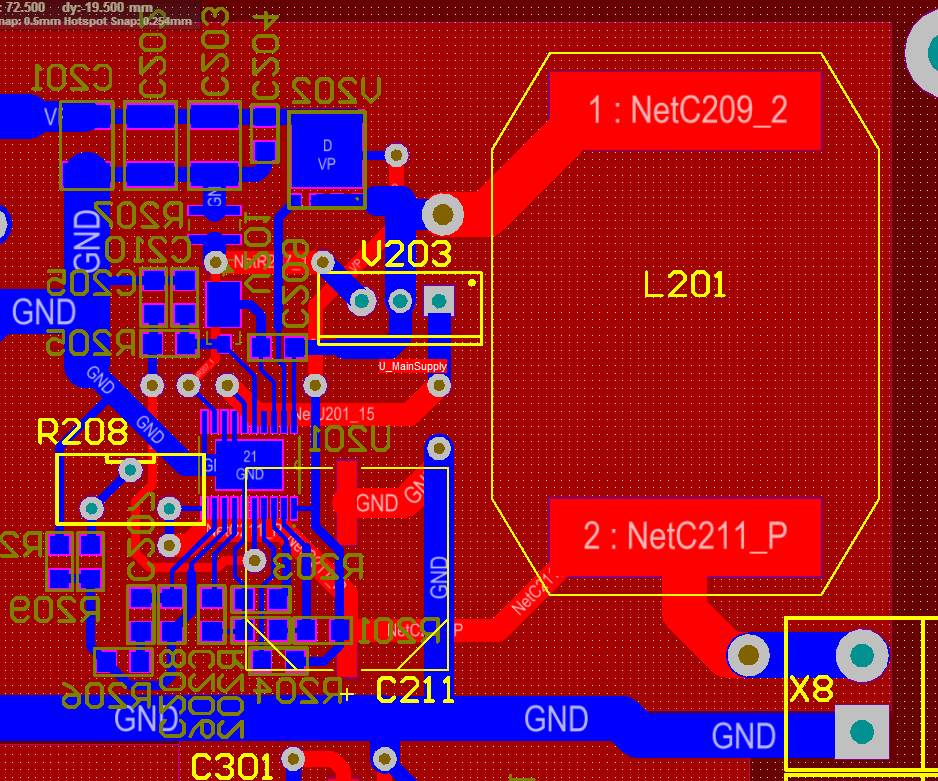

For some reason the chip just explodes as soon as I power the thing up...
Does anyone see my mistakes?

    The 650V CoolMOS for the low-side FET has quite high Miller plateau voltage. No need for a MOSFET voltage rating that high - maybe you can use the CSD19534Q5A NexFET also for the low-side device. Furthermore, it's important to locate the input decoupling capacitors as close as possible to the high- and low-side FETs to reduce parasitic inductance that leads to ringing, overshoot, etc.
