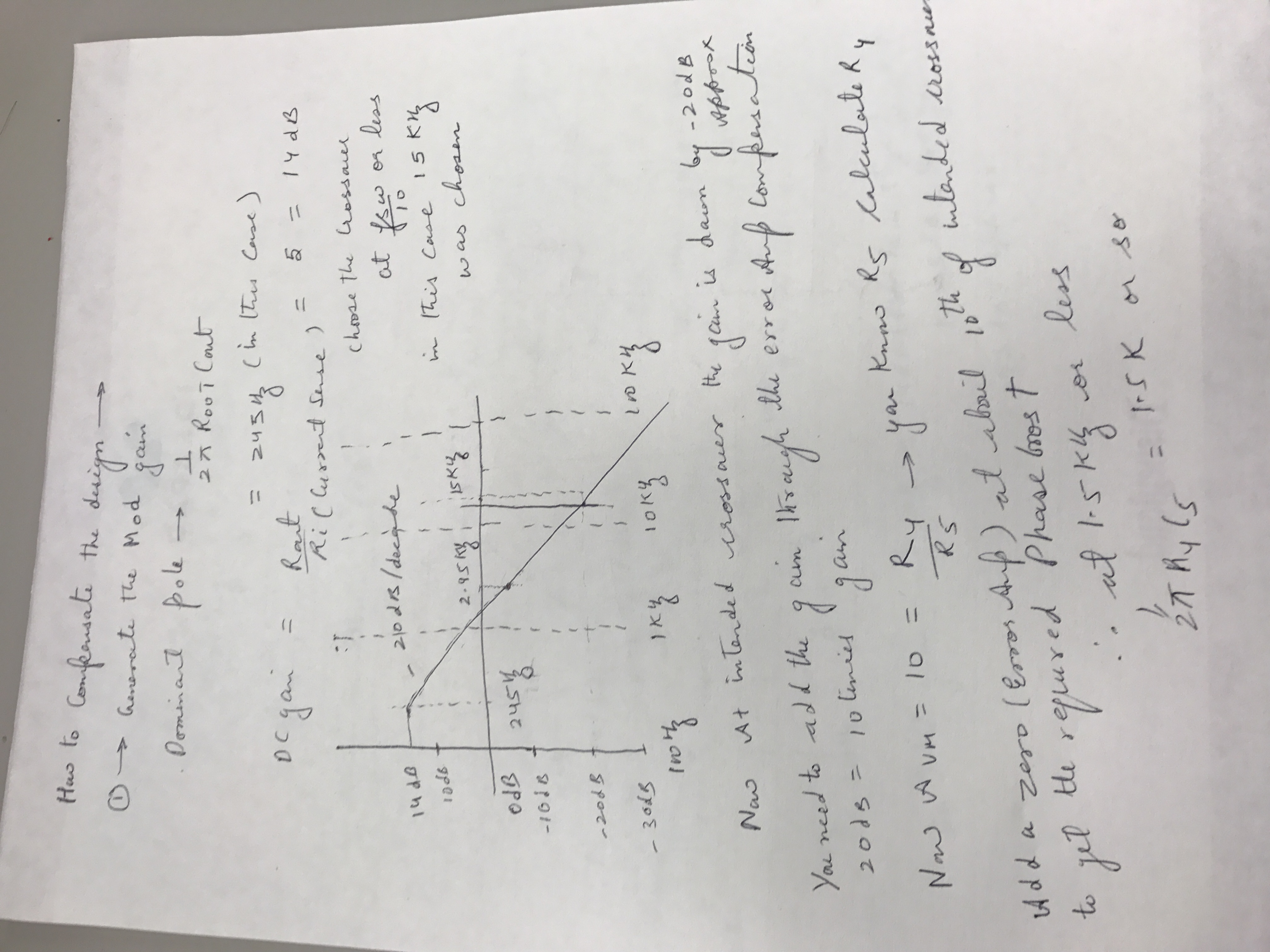

    we are using the LM5575 voltage regulator in our UPS reference design. We notice
    that during testing (loading the voltage regulator), by sweeping the duty cycle for
    more on time (and thus more current/power drawn from the regulator), the device
    goes out of regulation as the data that I provided for a particular sweep shows. Now,
    this is an existing design that I am supporting and keep running into this issue. I have
    tried different compensator values as calculated per the LM5575 datasheet just to
    see if I get different (better) regulation … to no avail. However, I did notice that the
    original designers installed an ES3B diode (which is an ultra-fast type diode) for D1
    in the datasheet (page 14) as opposed to a non ultra-fast type diode. Would this type
    of diode affect regulation.
    Can you please advise.

  • Hi Ambreesh,
    I do not see a 'delete' button to remove the posts as you requested. On another note, I believe that I have solved the issue as confirmed by testing. Apparently, when the LM5575 voltage regulator was designed, they used an ultra-fast diode. The datasheet specifically states to use a non ultra-fast type schottky diode. I changed the diode and now it is working ... no longer losing regulation for the entire load sweep. I also added the 22 uF to the input per your recommendation.

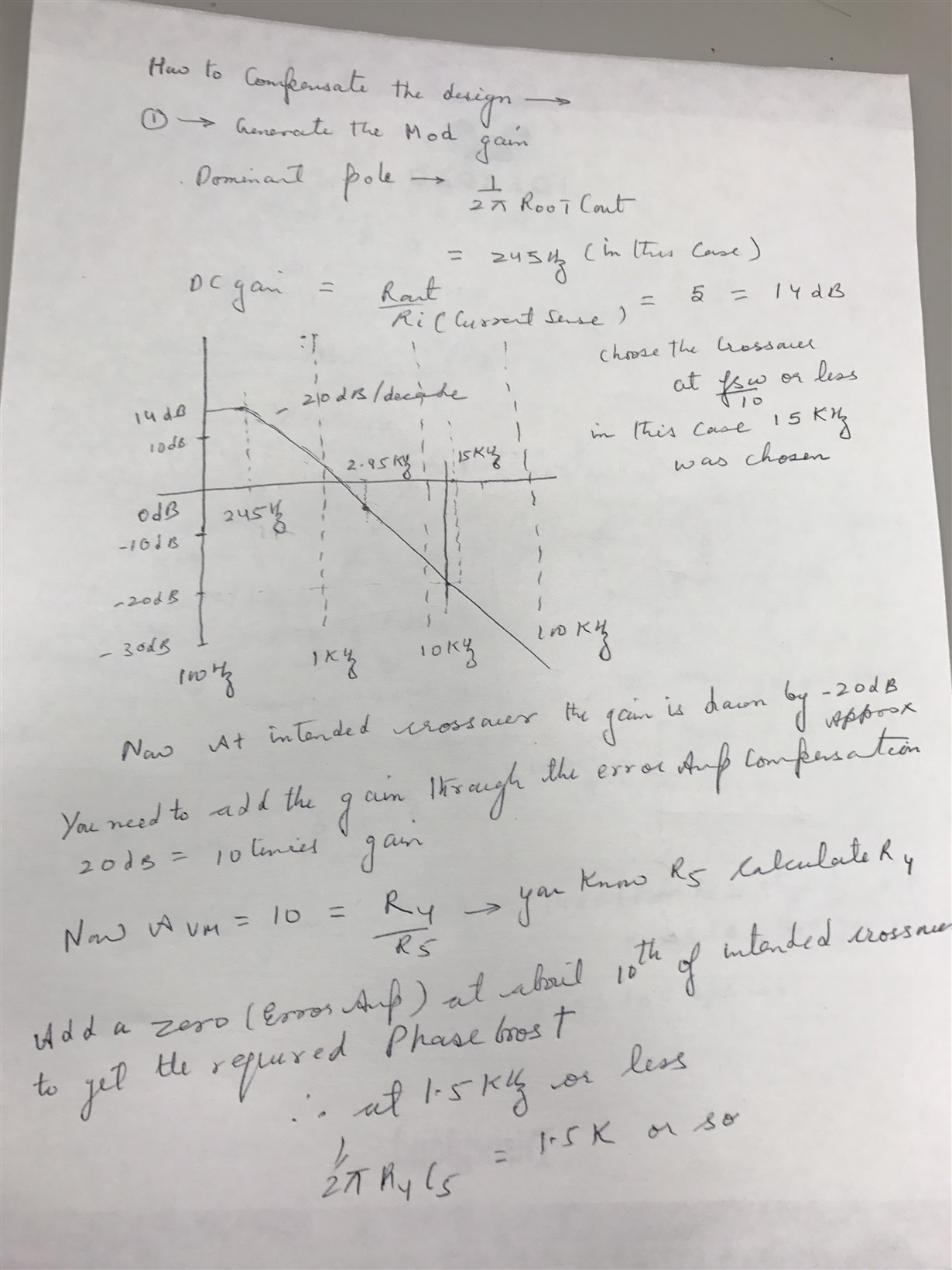

    For the R4/C5 selection, is it generally a good idea to select the error amp zero to be a few Hz above the modulator pole?It appears this way from the design example.  In the design example, Fm-p = 240 Hz, so they chose fea-p = 320 Hz. For our design, based on the load, it will generally be with a load of ~10 to 12 Ohms, with Cout = 205 uF.  This give a zero at ~60 Hz.  Should we choose the R4/C5 values to have a zero at ~200 Hz?  This would give us a crossover frequency of ~12 kHz (after cancellation and still having the error amp zero at DC)?
    On another note, Figure 19 in the datasheet shows a gain of ~42 dB at 100 Hz. This is supposed to be the overall loop gain. By definition (as stated in the datasheet): Overall loop gain = Mod (dB) + ErAmp (dB) = 14 dB + 20 dB = 34 dB. Am I reading this wrong? Why does it not show 34 dB instead?
    Saul
  • Saul ,
    I have addressed second  question first followed by first .
    Further you can optimize the design using Webench designer too .
    ---Ambreesh
