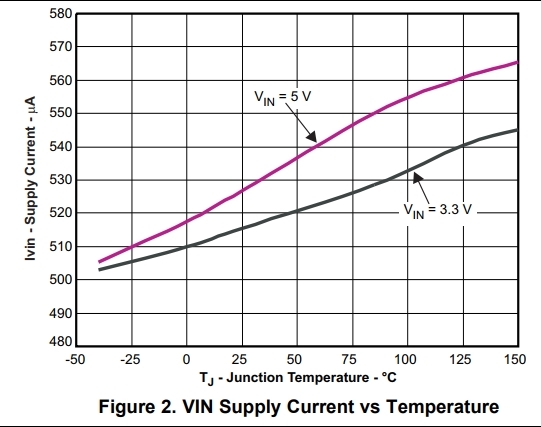

Hi
There is a Vin supply current data on the datasheet.
What is the condition of this data? (Vout and frequency and Iload)
Koji Hamamoto
  • That data is open loop test data. VSENSE is forced to 0.7 V to inhibit switching . There is no load. RT is set 78.7 k for a nominal 500 kHz switching frequency, but since VSENSE is 0.7 V, the TPS54478 is not actually switching during this test.
