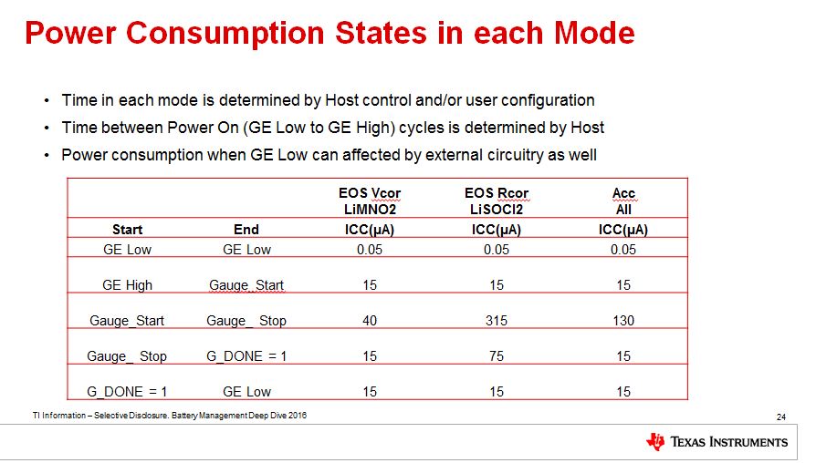

Hello TI Support,
In the data sheet is not specified what the power consumption when GE Input is set low? I assume this would be the shut-down mode power consumption.
The lowes number I saw in data sheet is 15uA(typ) and this power is too much for my application.
Thank you for your quick reply.
