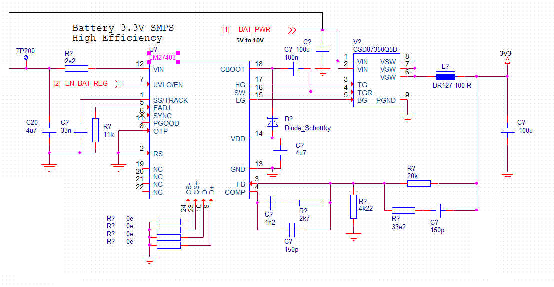

We want to use the LM27403 in our battery powered design, the WEBENCH assumes an efficiency of over 95%.
Since we only expecting loads below 1A, current sensing is not necessary. My question is, how to
deal with CS+/CS- and D+/D- if current sensing can be discarded.
OTP is pulled to ground.
  • Andreas,
    In general its not a good idea to disable current limit for safety reasons.
    In case you decide to do it then you can connect D+,D- to GND and CS+ to Vout. Would recommend leaving Riset from Vout to CS-.
    You could also leave the component as options to install in case OCP is needed to be added later.
    Mathew
  • Hello Mathew,
    thank you for the quick reply; we considered to make the OCP part "not mount", and even though
    D- would remain grounded (as you recommend), D+ and CS+/CS- would be floating / not connected as you recommend
