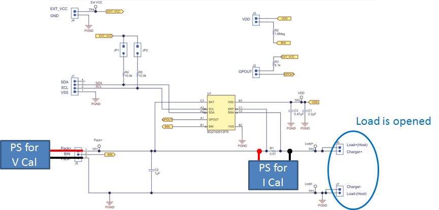

Please let me ask about current calibration of bq27426.
  1. How much current do you recommend to flow at current calibration by using bqStudio?
  2. Is following connection correct for current calibration?
