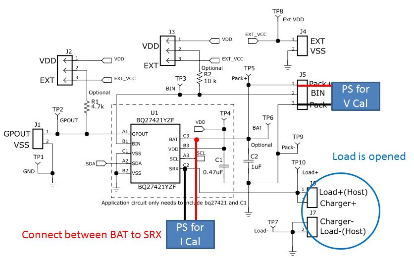

Please let me ask about current calibration of bq27421-G1.
- How much current do you recommend to flow at current calibration by using bqStudio?
- Is following connection correct for current calibration?
