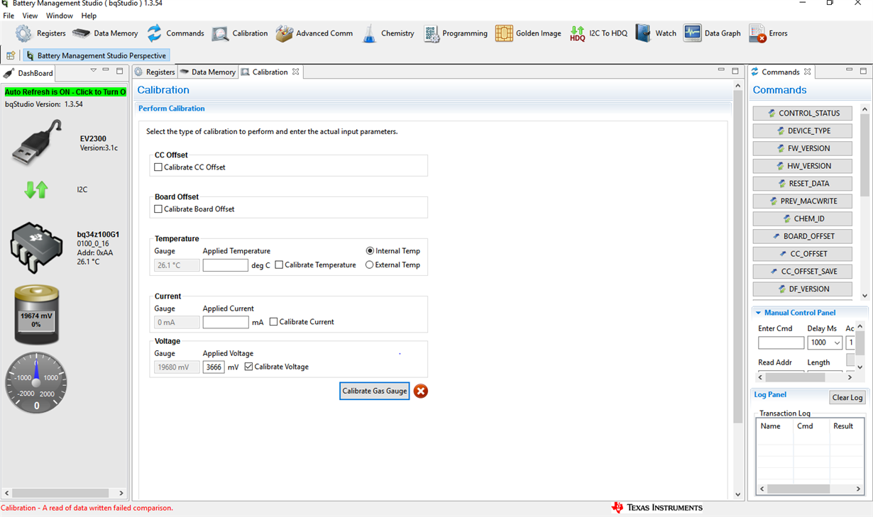

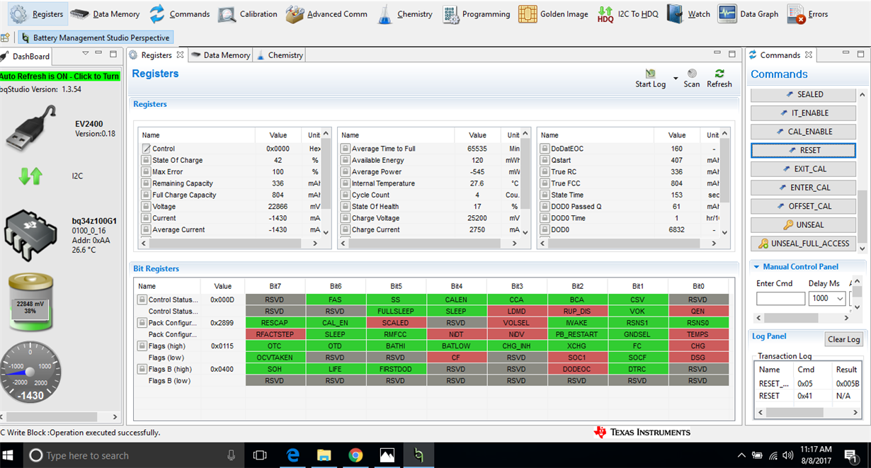

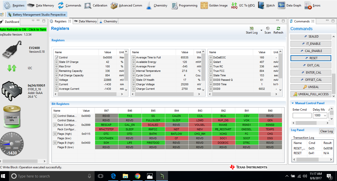

I am running a learning cycle on the Bq34z100G1 as specified by Thomas here:https://e2e.ti.com/support/power_management/battery_management/f/180/t/300700
The discharge cycle runs fine with the OCVTAKEN flag setting
However, during the charge cycle the CHG bit is not set. Also, the VOK bit is cleared during charge. This leads me to believe that the Q updates are not happening.
PFA the gg param file. The current has been scaled by 4 during calibration.The log file is for the first high current discharge at >c/8 . However, the OCVTAKEN flag is not set.
7801.params_test1.xls
5504.7_19.log
