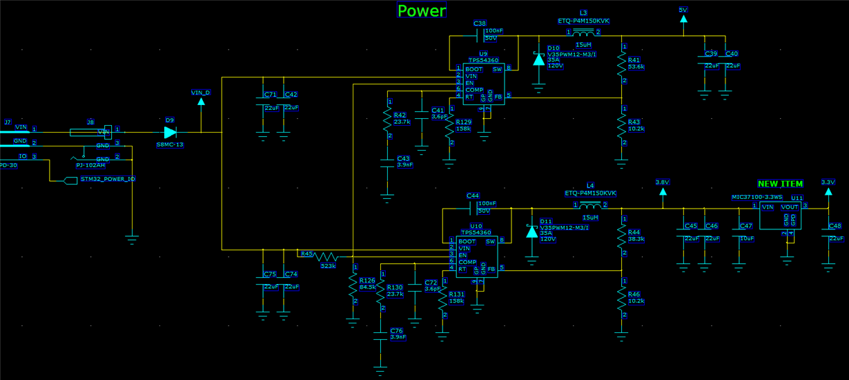

  • Well.. I'm planning to post my circuit for a review and maybe someone also get inspired form it.
  • Hi John,
    Do you have any comments about the schematic?
    Ogulcan
  • Did you have a specific concern? How did you calculate the component values?
  • Hi John,
    I've used WEBENCH tool to simulate the values, used it directly.
    But I'm planning to put extra 3000uF output capacitance all around the PCB (150mmx100mm area) in order to make it more durable to short electric cuts. If I can find space, I may put some extra capacitance (few hundreds) at the input as well.
    My only specific concern is its being failsafe and handle harsh automotive current spikes and/or voltage instabilities. Apart form that, I just need a general overview, that's all.

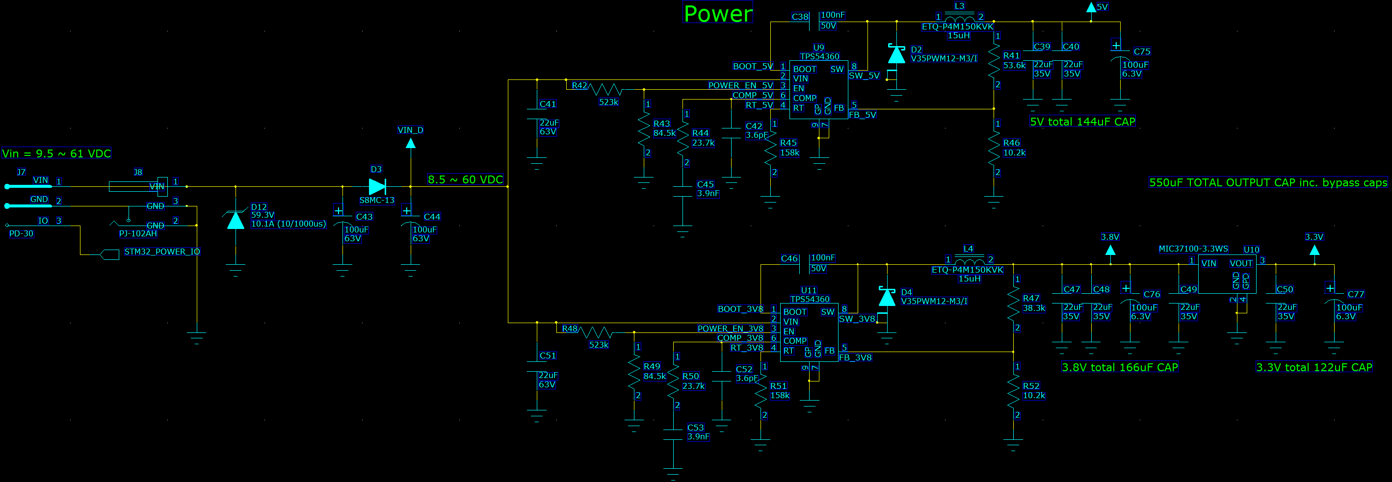

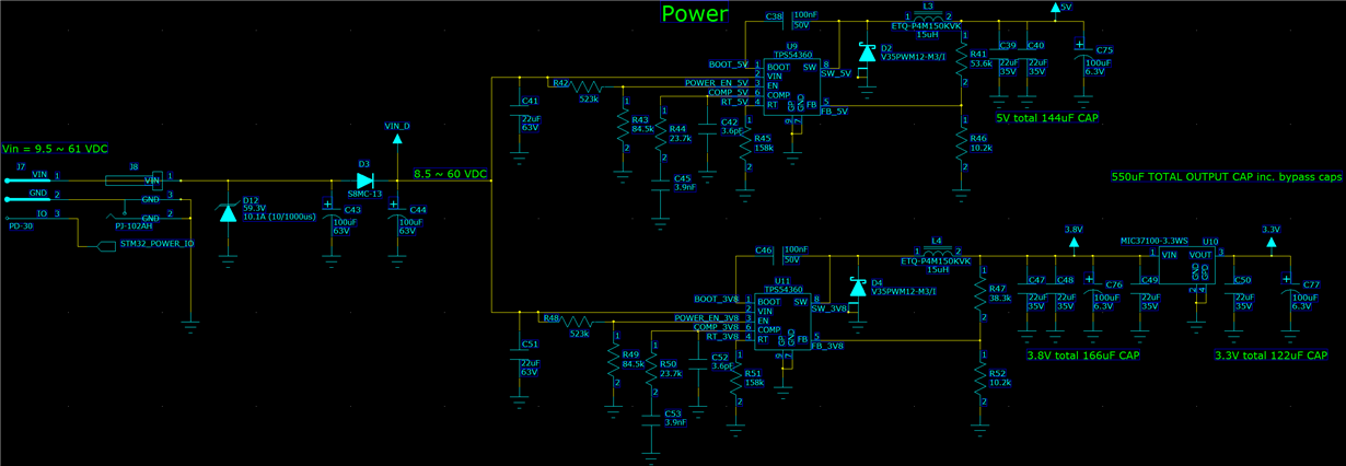

    Here is my latest schematic for review.
    What do you think about the output capacitance?
    Ogulcan
  • Mixing dielectrics with your output capacitors can make compensation more challenging. I suggest you ceck the loop response using the pspice average model available here:
    www.ti.com/.../toolssoftware

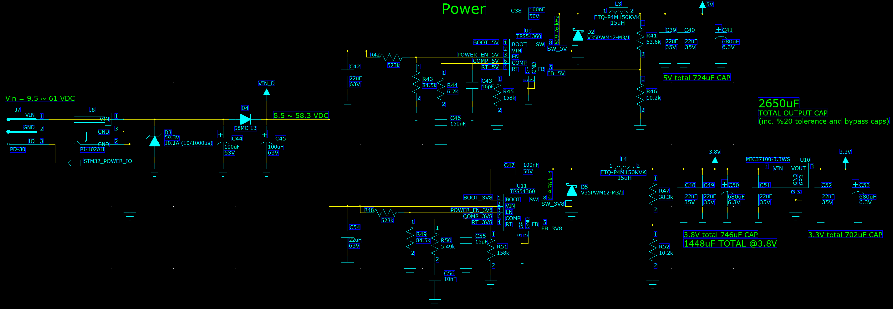

  • Hi John,
    Thanks for your feedback, I've been working on the compensations for a while.
    I managed to put larger capacitors to the output, so I made the calculations according to the above circuit;
    I had some difficulty in building the circuit in TINA-TI, however I managed to do the calculations using Octave (octave.org). Copying and pasting the above code will do the work;

    So, what I'm not sure about this compensation loop values is whether I put the nearest values or the smaller (or larger) values. This depends on whether the values are calculated specifically or could be under or below a limiting point.
    What I mean is, for example; I set the first resistance to be 6.2k. Do this value determine the lower limit so that it can also be 5k, or it has to be specifically 6.2k?
    Thank you.
    Ogulcan
  • I don't think that algorithm will work with mixed capacitor types in the output. You will not have a single ESR zero, but a zero / pole / zero instead. I would use the regular TPS54360 pspice or TINA-TI average model to check the compensation.

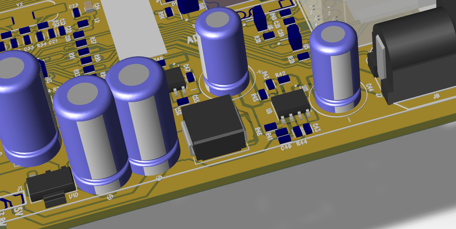

  • Hi John,
    Sorry for such a long thread.
    I will continue my simulations in mostly TINA-TI and hopefully finish today.

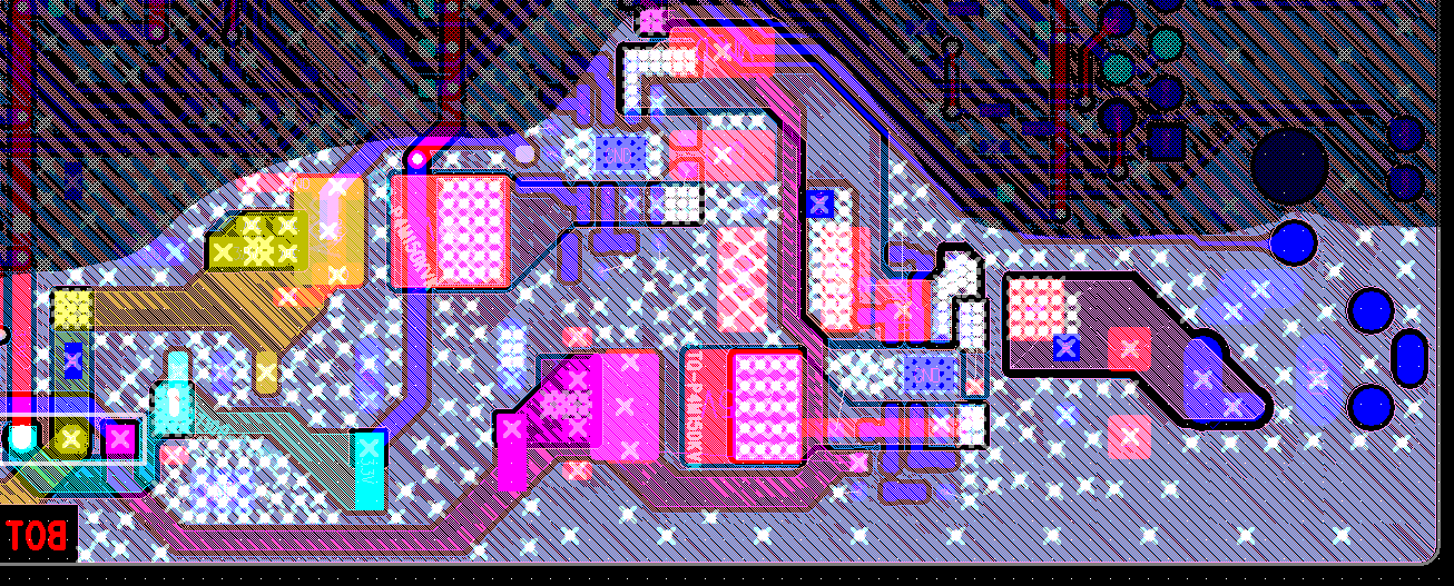

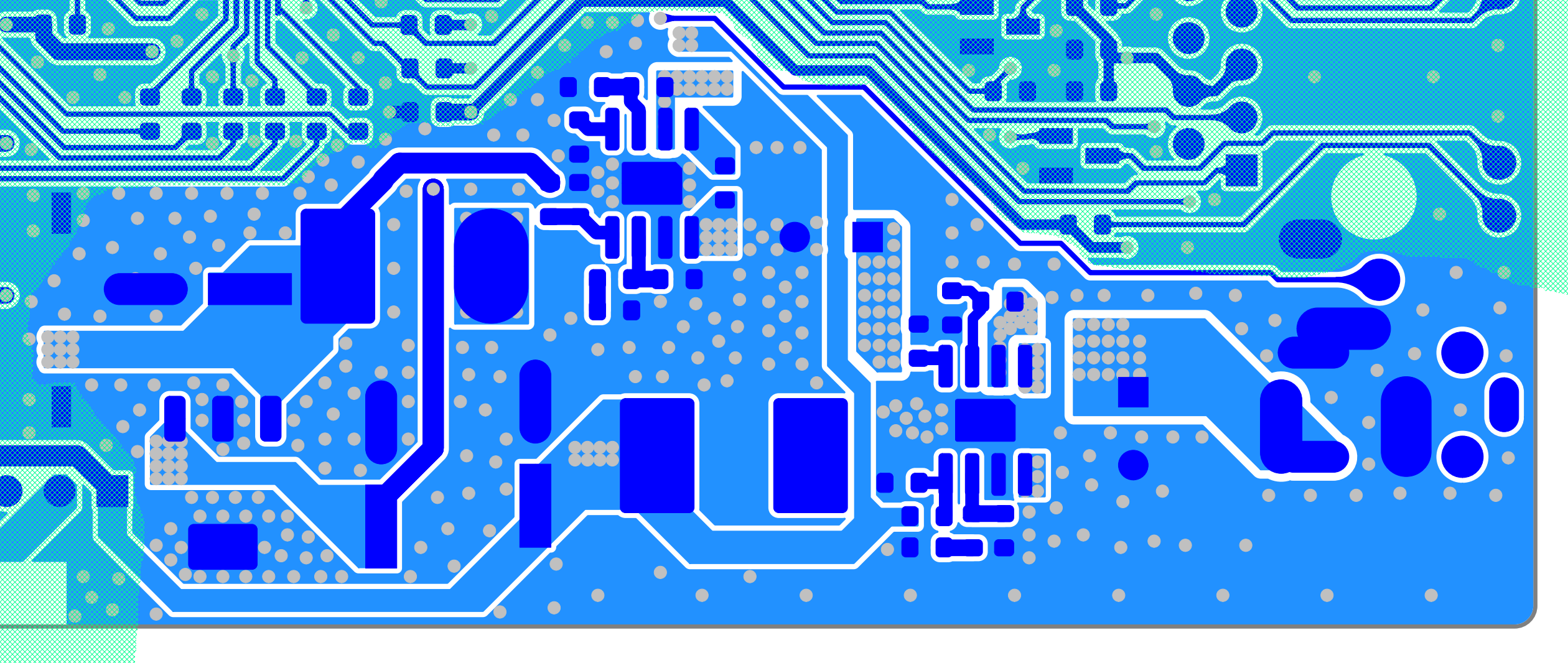

    In the meantime, here are my PCB drawings in 2D and 3D:
    Note that some capacitor 3D models are wrong, so no worries about that issue.
    Ogulcan
