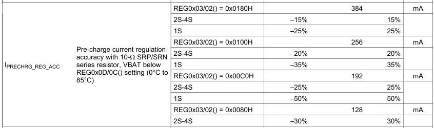

Part Number: BQ25703A
I understand that pre-charge current can be set to 64mA though 128mA is lowest value in electrical characteristics. Then I believe that the accuracy at 64mA will be lower than 128mA, right? Can you estimate rough variation at 64mA and 2S-4S like +/-40%?
