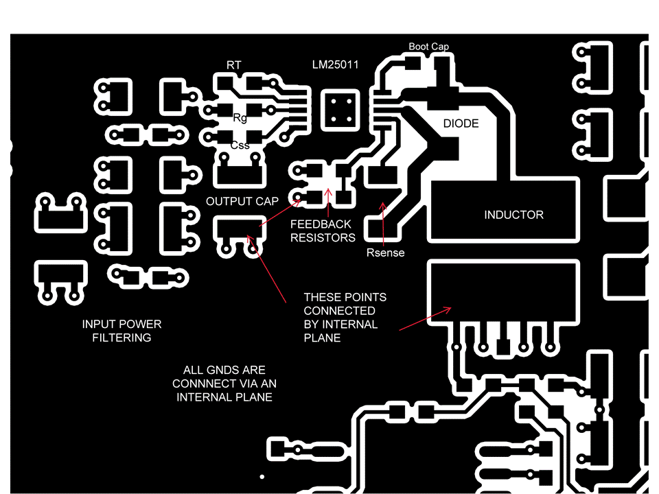

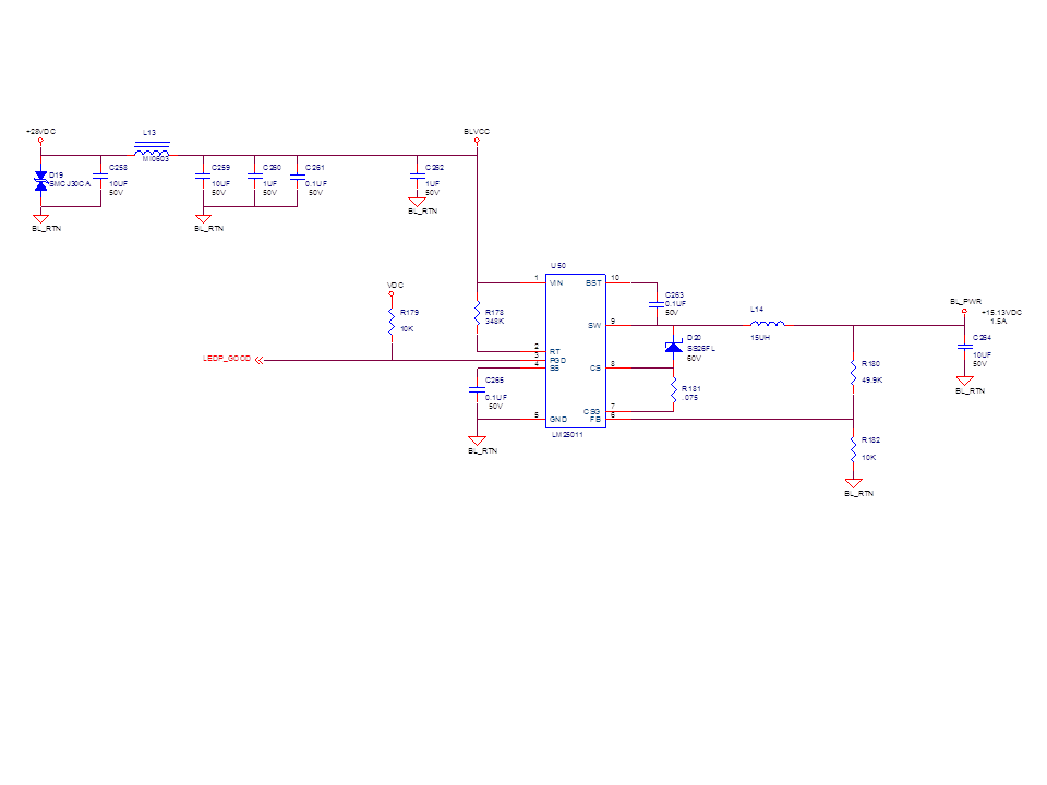

Using the LM25011 and the following parameters: Vin = +25V to +32V, Vout = 15V, 1.5A, I have implemented the circuit precisely as shown by WebBench. The circuit fails to produce any output. I can't figure out why. I have completely isolated the circuit from the load. I have added a small simulated load (15mA). Nothing seems to work. I haven't done anything special for ripple voltage (I'm not sure whether or not that is an issue). What I can say is that the RT node stays under .1V, The output steps up to about .8V and no higher. Input voltage takes about 6ms to get to ~15V and about 14ms to get to +28V.  Any thoughts?
